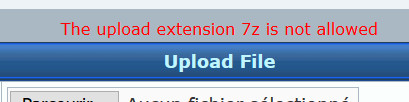

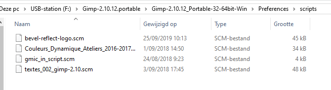

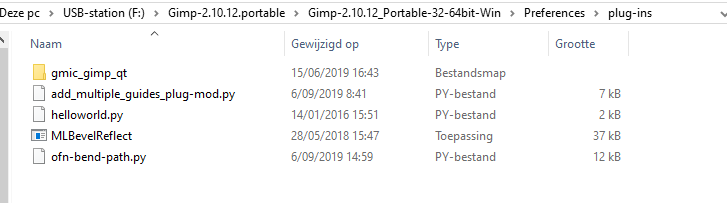

What's missing in my folders to let the Bevel Reflect Logo to work ?
I'm using Gimp 2.10.12 portable.
Thanks in advance.
Ella

Yes Diego, I browsed that topic. That's where I downloaded the BRL script and the plug-in.
Sallyanne, thank you for your reaction. Weird that it works for you in Gimp 2.10.12 and not for me.
The script is in my script folder and the plug-in in my plug-ins folder.
And I still get an error message.

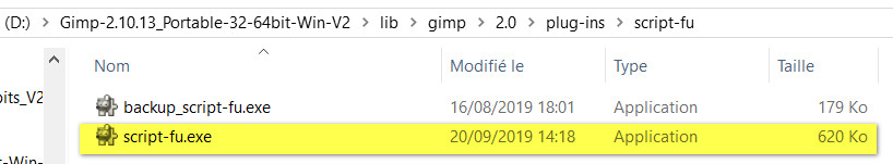

Hello Ella
did you put the script-Fu offered by MareroQ here:
viewtopic.php?p=242789#p242789
Edit:
1) In Gimp-2.10.13_Portable-32-64bit-Win-V2 \ lib \ gimp \ 2.0 \ plug-ins
I renamed the script-Fu present in "backup_script-Fu" and pasted that of MareroQ (620 Ko) (according to rich2005's advice):
2) in Gimp-2.10.13_Portable-32-64bit-Win-V2\Preferences\plug-ins,i have this file 59Ko
your MLBevelReflect is not the same size as mine ... I have the one of gimper66 put in another topic.
I wanted to put it here for you but I have this:

Thank you for your help and printscreens, level_10. I also watched Rich's video.
I removed and reinstalled the script and the plug-in, without success.
Maybe I have to remove and reinstall Gimp 2.10.12. I don't know ...

1) The MLBevelReflect that works on my PC is 59 KB (yours on your screenshot is 37 KB)
2) did you put the script-Fu.exe from MareroQ (620 KB)
 Post subject: Re: Bevel reflect logo
PostPosted: Fri Sep 27, 2019 4:50 am  (#8)
Posts: 2629

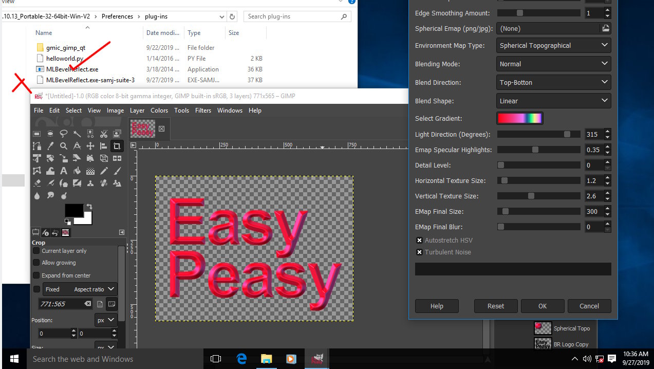

It looks like that 37 KB MLbevelreflect.exe comes from samj suite3 collection and for some reason does not work.
Disabled that and replaced with another version. This using a MLBevelreflect v.2 64 bit plugin. (and the AltDrag utility to move the ridiculous script)
Gimpers 60 KB plugin? Obviously works but it is a 32 bit plugin. Always better to use the correct 'flavour' depending on installation.

Thank you, level_10 and rich2005.
I deleted the script and the plug-in and used the ones in the folder from MareroQ and now it works :yes
Problem solved :)
