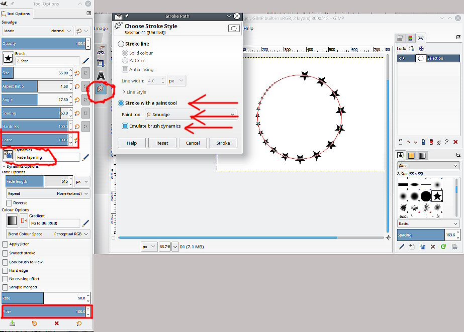

PostPosted: Thu Oct 24, 2019 1:43 pm  (#6)
Posts: 2629
Try:
Using smudge tool - with brush -set spacing - Force = 100 - dynamics Fade Tapering - set fade length - Flow = 100
Stroke path - with paint tool - set paint tool to smudge - enable Emulate brush dynamics.

PostPosted: Thu Oct 24, 2019 2:30 pm  (#8)
rich2005, I found my mistake
 Post subject: Re: brush dynamics
PostPosted: Thu Oct 24, 2019 2:37 pm  (#9)
I left "brush" and not "smudge"
Thank rich2005 and OMG!
