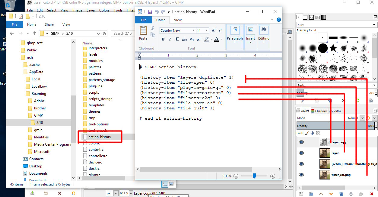

There is another record, a bit like dinasset's filter name with no parameters. In the gimp profile there is a file 'action-history'. Snag? Gimp writes that when it is closed not while editing is in progress.
