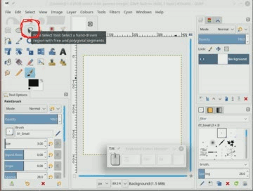

Make sure you are using the free-select tool - seem to recall some difficulties in the past.
Then it is as david describes
click -> click -> click -> click -> ENTER
