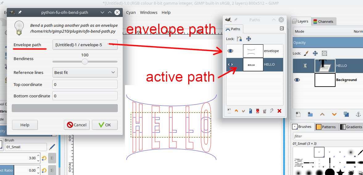

You are almost there. The Envelope path should be top +bottom (haut+bas) example:
Also you might run into problems with the length of the paths. Better to have slightly longer than the text.
