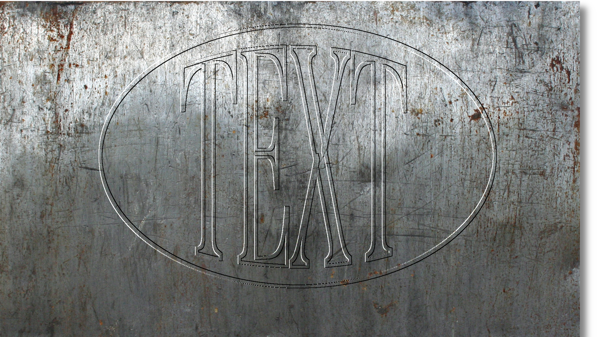

PostPosted: Tue Dec 03, 2019 2:18 pm  (#2)
With limited capability you can use Lens Distortion
from
to

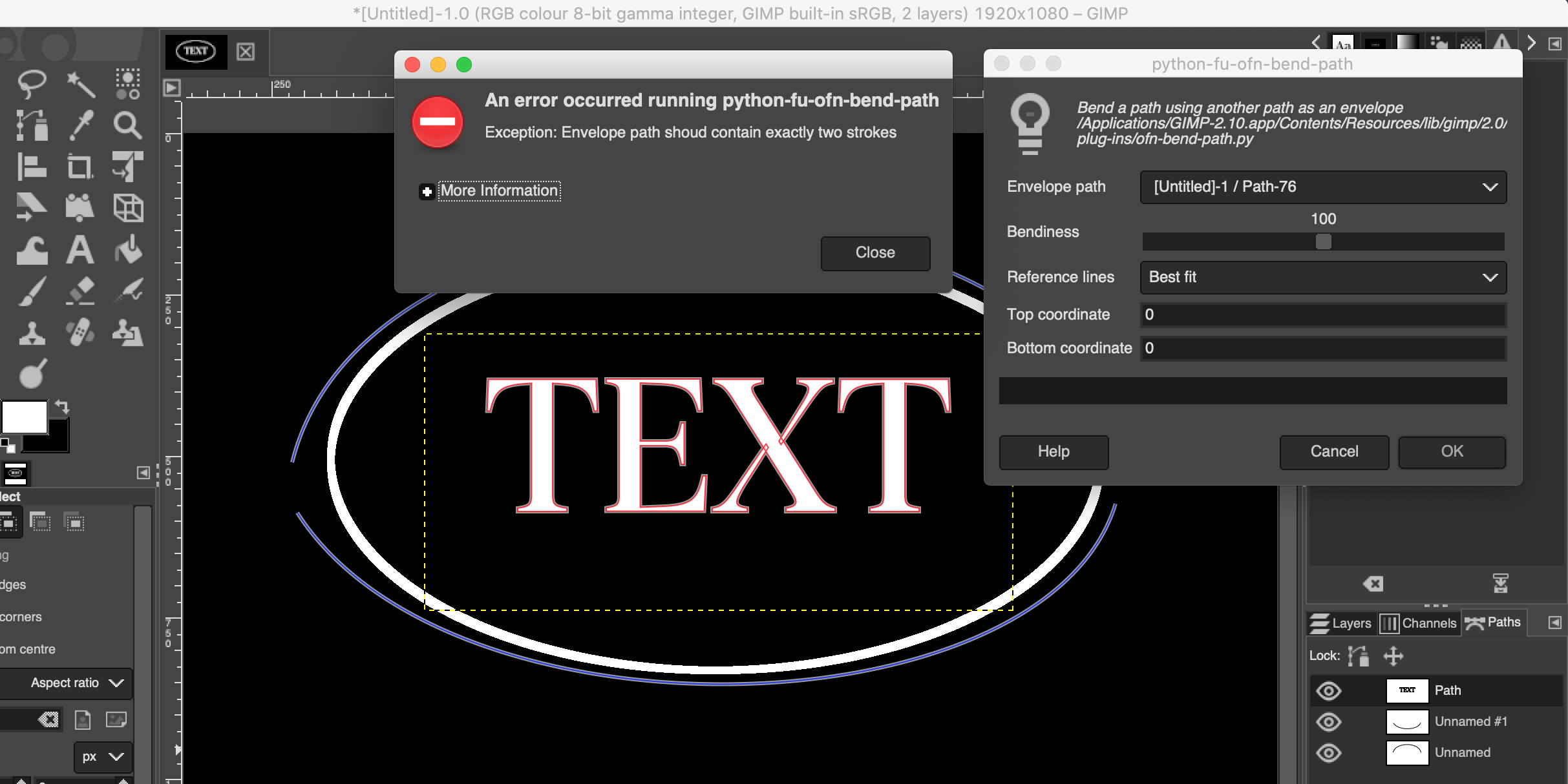

I seem to be having trouble with my paths :(
Error = Exception: Envelope path shoud contain exactly two strokes
To draw a path I click once at one end then once at the other and then drag the centre to shape. Is this the correct way?
method:
ellipse > stroke
top path
bottom path
text > text to path
Paths>tools>bend

PostPosted: Wed Dec 04, 2019 5:51 am  (#6)
Joined: Sep 20, 2016
Posts: 293
Currently your envelope is made of two paths. You must unite them into a single path.
The script needs a text path and a single envelope path, made of two strokes.
Tutorial:
https://gimp-science-labs.blogspot.com/ ... ug-in.html

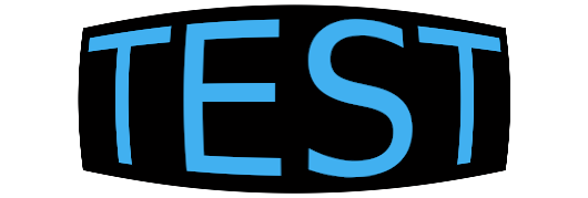

PostPosted: Wed Dec 04, 2019 8:26 am  (#7)
Joined: Nov 25, 2019
Posts: 12
Cheers! I'll get there... eventually :)
