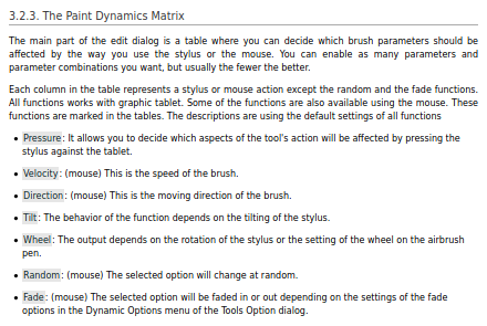

I'll follow your lead and post (some of) the documentation regarding "the dynamic matrix", to fill out the post for a possible future visitor ("Greetings, Visitor from the Future.").
I'll start by observing that "a dynamic matrix 'connects' mouse or tablet stylus 'actions' to individual brush 'parameters.'" (Note: at least in 2.10, matrixes cannot be edited for "standard" offerings, which must first be copied to be editable.) Note too that some of both the actions and the parameters are irrelevant to the mouse. That said, the mouse/stylus 'actions' columns are in the first image, and a sampling (just two) of the 'brush parameters' rows are in the second. Note that the Angle one I need is missing... :gaah, but too that the parameters can be influnenced by a stylus or a mouse.
Furthermore, because the documentation involves references to "speed" and "direction" of "the mouse," it's beginning to dawn on me that Edit->Stroke Might Not Use The Mouse, but I will continue this thought later.
Shows only Size and Angle. Nine (!) more, incl. opacity, hardness, jitter...
