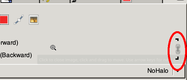

Click on the chain link at the top right of the Tool options to open it (yes, the difference between open and closed isn't very visible)

@script coder Boy you have eagle eyes. Thanks so very much for solving my problem.
