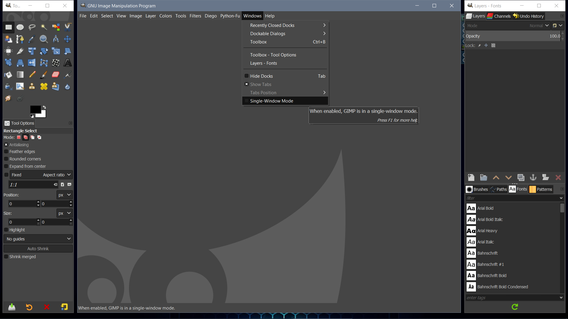

You can also try disabling Single Window Mode,
to see if this helps.
My example screenshot below,
shows how it looks without Single Window Mode enabled.
Simply remove the check mark from it's box,
to disable Single Window Mode.
