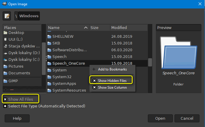

It probably won't help - a very stupid question: You turned on the display of hidden files?
