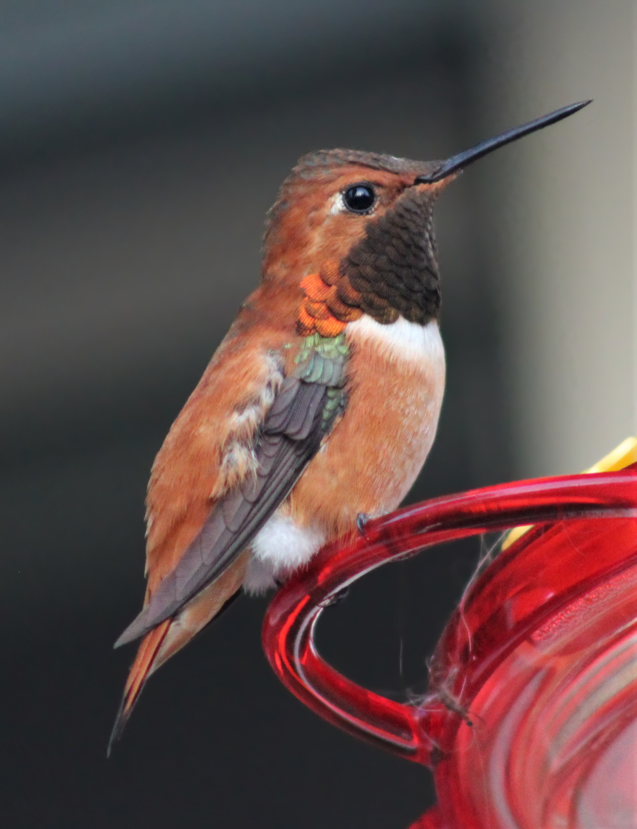

Hello GimpChat peeps...
I'm bleedingly new to the forum, so go easy on me... I know there are search options, but there are SO many options for specific needs when it comes to GIMP, I don't know where to start.
I have an old Photoshop knowledge base, and VERY basic GIMP (old as well) knowledge base. I'm technical by trade, but stopped using photo editing a long time ago as complexity, to me, fell out of interest in favor of other aspects of life; however I have a knack for photography and am trying to get back into the hobby.
Anyway, that extremely brief background aside...
With the wonders of GIMP I know there are numerous plugins, which all offer their more or less complex means for manipulating a photo. I also know the "basic" included features of GIMP are quite powerful in and of themselves.
I have a Canon Ti3; and sadly stock, out of box lenses. I've had the camera for YEARS now, and I know, I know, these lenses tend to lend themselves to grainy photos, as I'm sure a lot of you may know. The photo example I'm posting is of interest to me. Although I know its not a .RAW file on my hard drive, I'd like to do what I can to enhance it without spending hours of life searching how to clean it up, or working on it to do so.
Specifically I'm wondering what the best methods of removing / cleaning up grainy back grounds would be? Layering, then editing? A "magic" tool (plugin?) to do the job? The subject of this photo I think is well(ish) in focus, but the background is horribly grainy. Is it salvageable? And beyond the back ground, is the main subject "clean-up-able"?
Is there a detailed, newbie friendly walk through available to do the tasks at hand for GIMP version 2.10, or an intuitive enough tool available to complete the job?
Anyway, thank you all in advance.

I would select the background and then edit with blur .. very simple

I actually purchased an app from MacPhun called Noiseless, and was very disappointed in the results from using it. I found that Iain Ferguson's old noise reduction script in GMIC actually worked better. I use the same camera model as you do, and had to upgrade my lens to get away from the noise element that is so common with stock lens. Here's a sample of Iain's script at work. It's not perfect, but its a good start.

My go to tool for noise is Nik's collection 'de fine'. Gimp is able to call it now

Thanks for the post about G'mic's Ferguson's old noise mahvin. I don't believe I've tried that one before. It works well.

Wow wow wow... First of all, to all who replied THANK YOU.

If by honey eater, you mean nectar, yes it is. This particular bird is a Hummingbird, specifically a Rufous Hummingbird. It visited my back yard while flying through on its migratory flight the other month. It's rare to see such a breed in my area, and thus is why I wanted to clean the photo up a bit. My aim isn't to remove details of the bird itself, its a beautiful bird! But to remove the static, or grainy mess from the background so when I go to print the image for my collection I have something that is easier on the eyes.
@sallyanne & @racer-x -
Honestly of the examples / suggestions everyone was so kind as to share, I think I like this idea the best. This "G'mic Ferguson noise mahvin" tool seems to have the best balance in cleaning up a photo, without going too far into softening up the primary subject to my eye. Where can I find this plug-in (do you happen to have a link I can use)? Is it fairly intuitive or is there a good walk through for being able to take advantage of its uses? And do you know, is it compatible with GIMP vr 2.10? I tried running a quick and simple search online just now but wasn't able to find anything related to it.

There are two places in the GMIC plugin that you can find Iain's filters for noise removal
Under Repair in GMIC
Also under Testing

Did you download GMIC from their website (I left in the link)?
Let me know where you are in this process and I'll start from there.
