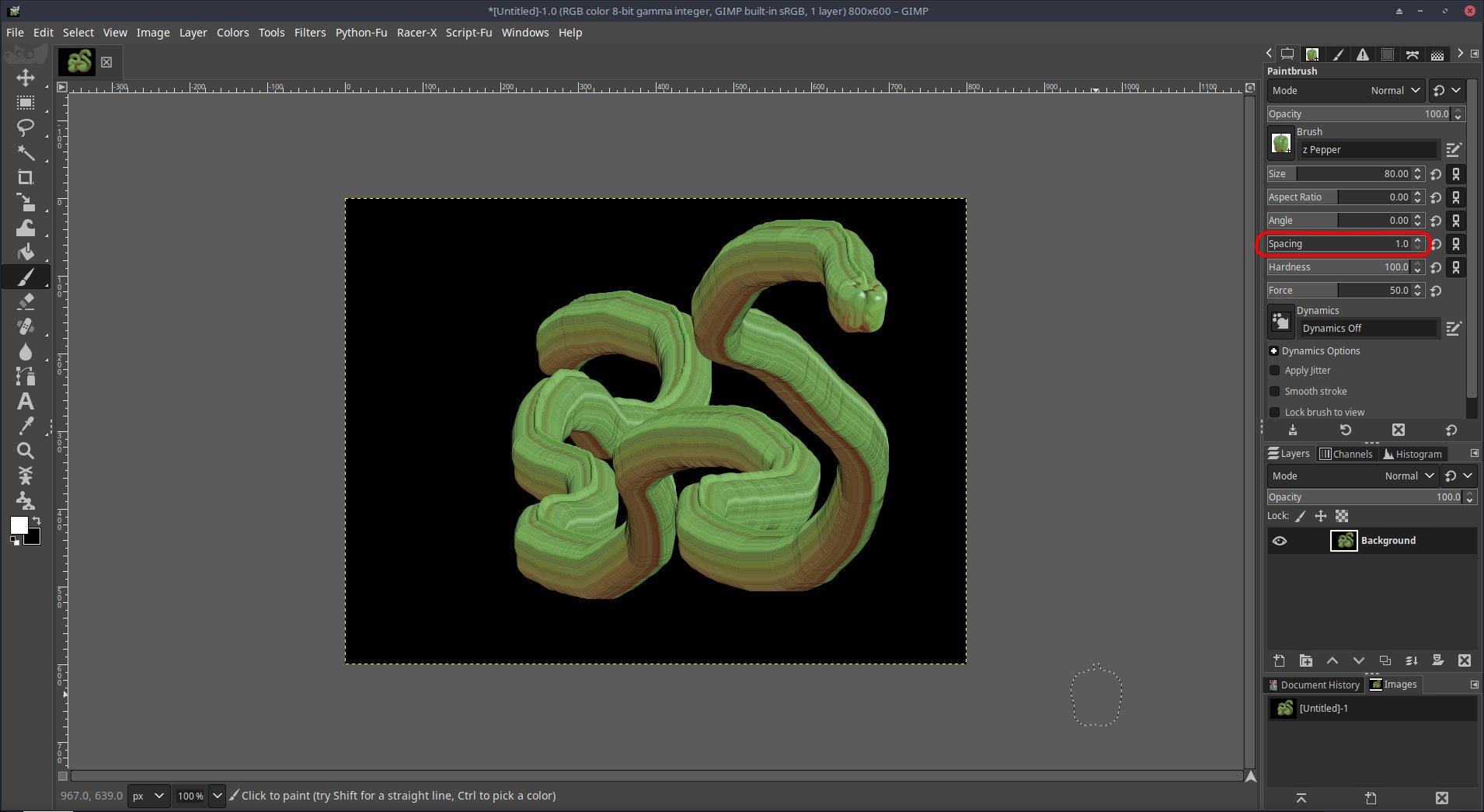

Maybe I don't understand your question? Why not make a 3-D brush and lower the spacing?

Racer,
My ultimate goal is Real 3D as against something that "looks" 3D. I actually "carve" the heightmaps into wood: like pegleg44.
So I'm trying to make something that, when carved, will look like a forest of trees from above.
