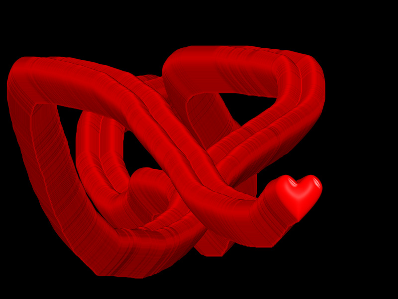

Maybe I don't understand your question? Why not make a 3-D brush and lower the spacing?
