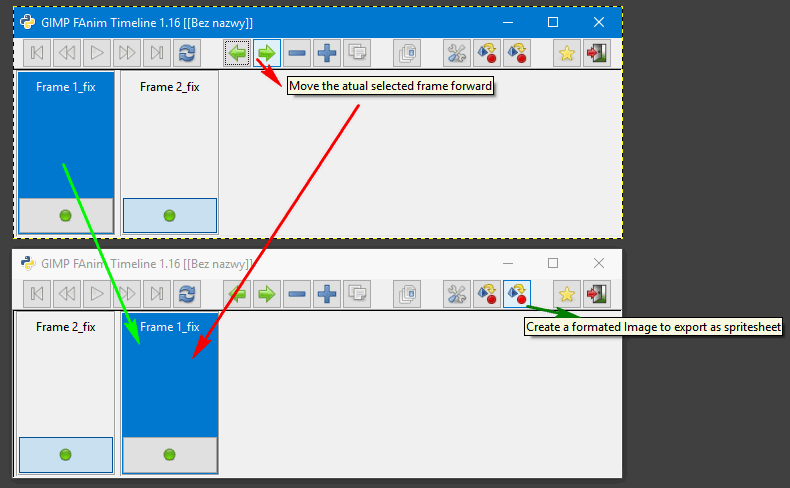

Pending details and the new script, you can try:
1. ofn-layer-tiles.py (instruction in a zip file in html version)
https://sourceforge.net/projects/gimp-t ... s/scripts/
2. GIMP FAnim Timeline.py
https://github.com/douglasvini/gimp-fanim
Yes, but ofn-tiles will work directly from the files (and can also cut/export back to tile files).
