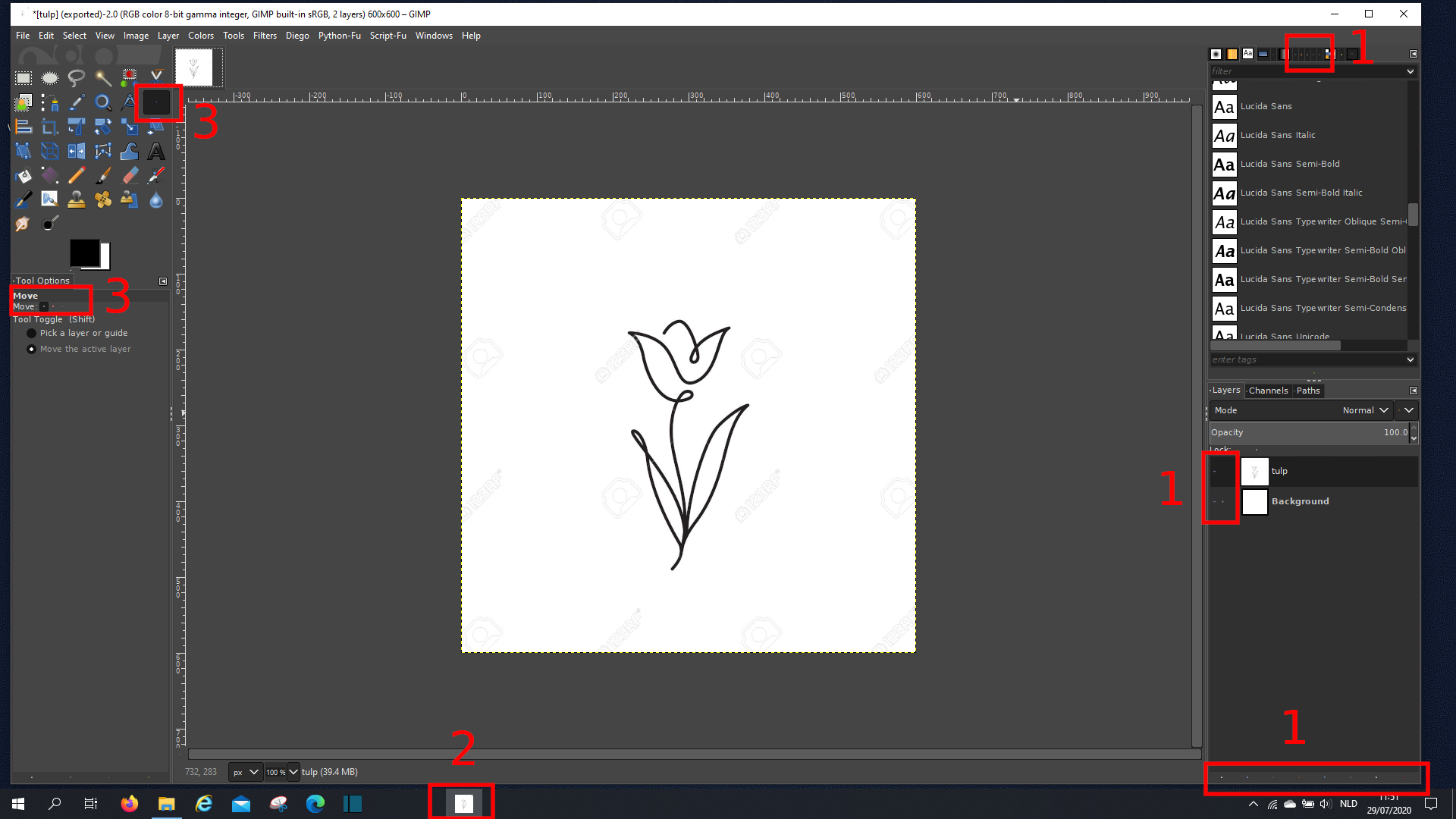

I work with Gimp 2.10.8 portable and suddenly several icons have disappeared (1).
On the taskbar the Wilber icon is now very blurred (2).
Also the move tool icon has become just a dot (3).
Can somebody help ?
Thanks,
Ella

Maybe you gimp just needs refreshing. I assume you turned it off and back on again?

Has your problem been resolved Ella? This hasn't been a problem since vs 2.8.14

I turned Gimp on and off several times, but the problem remains, Sallyanne.
It's the first time I have this problem with 2.10.8.
Is there a newer portable version?

Partha has a 2.10.18 portable. https://www.partha.com/
I have not used it so cannot say if it is good or not. I use the 2.10.20 normal version.

PortableApps currently have 2.10.18-2 Portable GIMP
2.10.20-1, which has been well received, will be released in 2/3 weeks

Have you tried selecting a different theme, to see if switching themes will displays the missing icons.

Samj has 2:10.21 portable
https://samjcreations.blogspot.com/sear ... results=22

I would first try playing with the icon theme and the icon theme size settings.
Edit/Preferences/Interface/Icon Theme

Downloading version 2.10.18 did not solve the problem.
After that I tried to switch the icon theme, again without result.
With the link from Sallyanne I downloaded and installed version 2.10.21.
For now this works excellent.
Sallyanne, 00111111, Wallace and Nidhogg, thank you all for the help.
