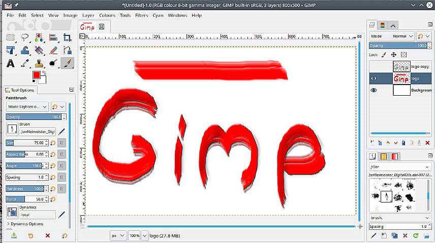

Here is a screenshot of my gimp.
I'm using Gimp 2.8.18 for this,
but it can also be done within the latest version.

 Post subject: Re: Brush help
PostPosted: Sat Aug 01, 2020 2:29 pm  (#8)
Joined: Nov 19, 2019
Posts: 209
Thanks @Wallace. When I tried, the brush gave a few dots. When I dragged it, it was a series of dots again. I am not sure what is going wrong. I am not able to replicate the crispness in the examples I posted. :(

Maybe reduce the spacing. I'm having a look at the other brush that you wanted evaluated.

Reduce the spacing to about 4 or 5

Here's another example.
With the spacing at 3.
