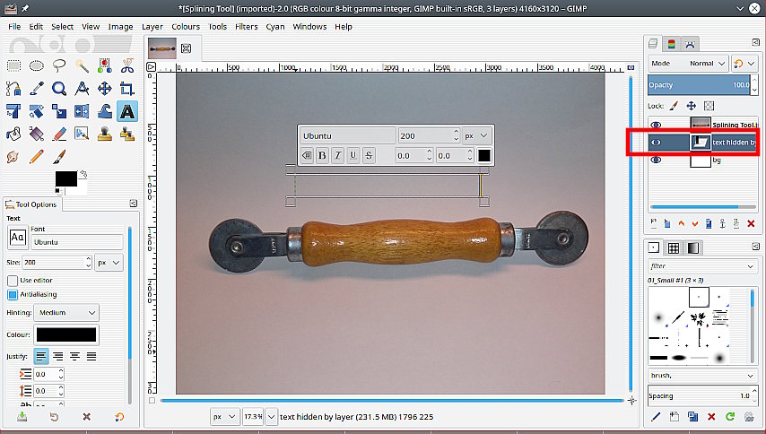

Apparently, typing in text in a jpg in GIMP 2.10.14 has changed from 2.8.2
In prior versions, I would open a .jpg in GIMP and drag the cap A letter from the Toolbox (on the left) and then enlarge that Text Box by dragging one of the 4 comers of that box withing the jpg.
I would then left click the mouse in that box and started typing. I could change the font size and style.
Now, when I start typing in that box no characters appear.
The text I typed appears under the GIMP box and where it displays the down-pointing arrow with a little box with the letters px in it.
The text does not appear in the jpg.

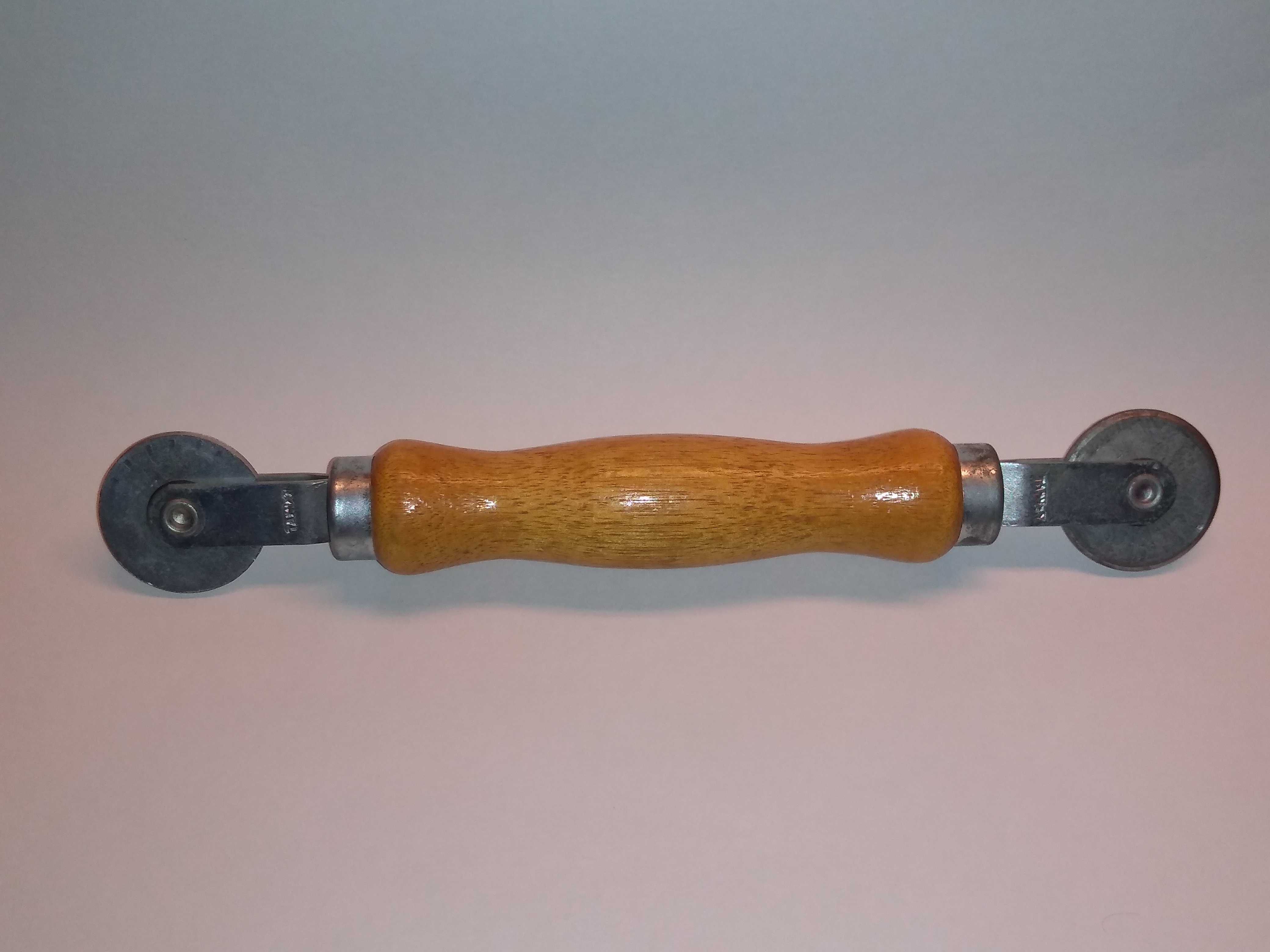

I then tried to import a .doc file (created in Libre Writer) with just the words Splining Tool in it and nothing else. But, nothing happens.
Can you please share the precise step-by-steps to creating text in a .jpg and/or how to inserts a text file into a jpog into GIMP?
I searched the GIMP User Manual and it stated you just click the cap Text and then start typing.
Thanks.

The only difference between Gimp 2.8 and Gimp 2.10 is the way the on-canvas text tool displays. Changed because most users thought the 2.8 handles were too large.
Gimp has never been able to import a .doc file Sometimes you can select/copy from an open document and paste into the Gimp text tool.
Sallyanne and Wallace advice is best. The Jpeg is quite large, small text / colour of text will play a role. Always use the Text Tool options not the on-canvas tool.
One thing not mentioned is the position of the text layer. It is inserted just above the active layer. Text is hidden by a higher layer. You will see the entered text in the layer name. No name = No text inserted.

I could easily click the Text Tool in the toolbox along the left and place it in any graphic and then start typing in 2.8
In 2.10 the text types into a thin rectangular box along the bottom, not in the graphic itself.
Look at the graphic you enclosed. See where it says px 17. then an arrow then text hidden by layer (etc.) That's whee text is being typed into, not above or near the tool.
That place is just the name of the active layer(*). In a text layer, the layer name is by default the same as the text content, so when you enter text in the layer, this place is also updated as a side effect. Otherwise, Rich is likely right, your text layer could be masked by some other layer, check your layer stack.
(*) To be accurate this is the name of the active drawable (layer, layer mask, or channel), ie, whatever Gimp tools will work on.

Could anyone please possibly do me a huge favor and simply replace the white background of these wire cutters with a black background with the words Wire Cutter in black letters centered on top and share that changed graphics with me?
Thank you.
