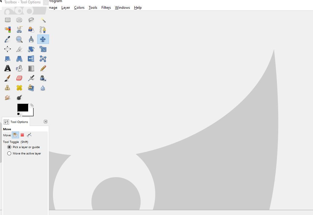

 Post subject: Re: Moving characters in a jpg
PostPosted: Thu Aug 13, 2020 12:20 pm  (#6)
Posts: 1575
It looks like you can't see your layer dialog.
Click ctrl+L to show it.
Or mahvin's solution "Dockable Dialogs" > layers
viewtopic.php?f=8&t=18660
