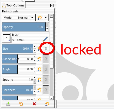

I have my GIMP controls set at a default of 300 DPI pixels/in - yet EVERY SINGLE IMAGE opens at 11.8 DPI which is pixels/mm instead of pixels per inch. This is a ton of extra work but I don't know what to do about it?

Also, my brush sizes are giganticus - up to almost 7000 at times. I reset a brush and go to the next one and it reverts to 'huge' also.

Large brushes. Gimp 2.1O will open a brush at its natural size, some PS .abr brushes can be 2000+ You can go back to the Gimp 2.8 state by locking the brush size. Then next brush will use the last brush size that was set, big or small

1. Brushes: THANK YOU for the rescue on the brushes. Your fix works perfectly! What a relief.
