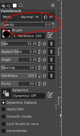

I try to use the paintbrush and nothing happens. Every other tool works perfectly the only problem is the paintbrush tool. It does absolutely nothing when I click. I don't get any error message and at the bottom of the screen it tells me I can "click to paint" but I click and nothing happens. I use the eraser and I can erase just fine. The image mode is RGB the paint mode is normal no matter what brush I use nothing happens. I reinstalled the program and absolutely nothing. I only have one layer and I can erase on it just fine. I have the whole image selected. But still nothing happens? It worked just fine yesterday but at some point it stopped for no reason. Can someone help me please? I can't use gimp anymore.

Check if the Opacity of the brush is on 0.
The opacity is at 100. Is that good?

Heres a screenshot
File comment: screenshot

dahofoc341 wrote:
not according to your screenshot ;)
Not surprising the brush does not show.

rich2005 wrote:
dahofoc341 wrote:
Hey rich2005, that is what I told him in the post#2, the brush opacity is in the 0 position. But I guess he didn't read it.
 Post subject: Re: Paintbrush doesnt work and none of the solutions on the internet w
PostPosted: Tue Sep 01, 2020 2:51 pm  (#14)
Yes, I should have done a better job of reading your post, however, it appears you need to set your
paintbrush "normal" layer mode to something higher than 0.
