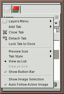

Click on the menu button in the Layers Dialog (it is the "triangle-in-a-box" button in the upper-right corner) and make sure that the "Auto follow active image" item is checked.

Wow, thanx so much Saulgoode.
I don't know how that got unchecked but it was driving me nuts.
