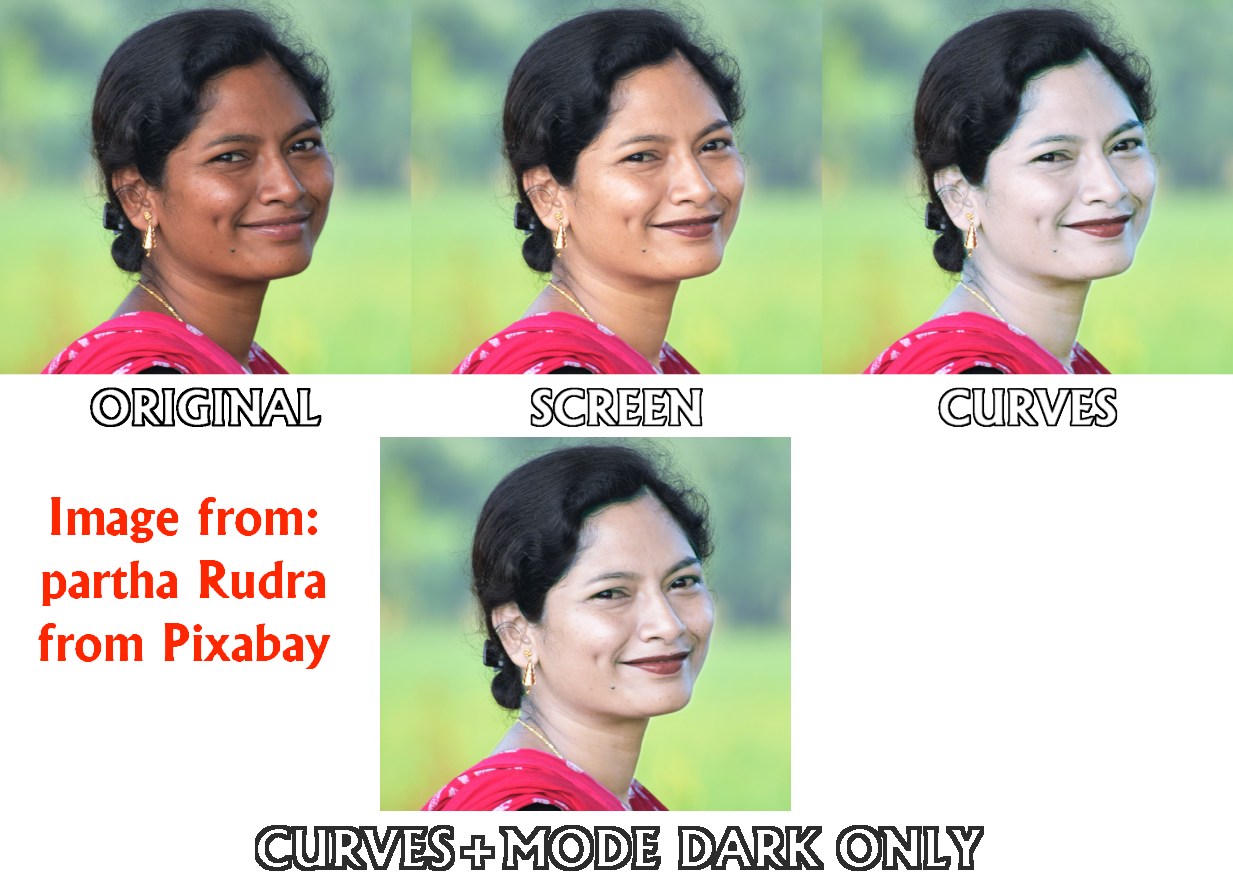

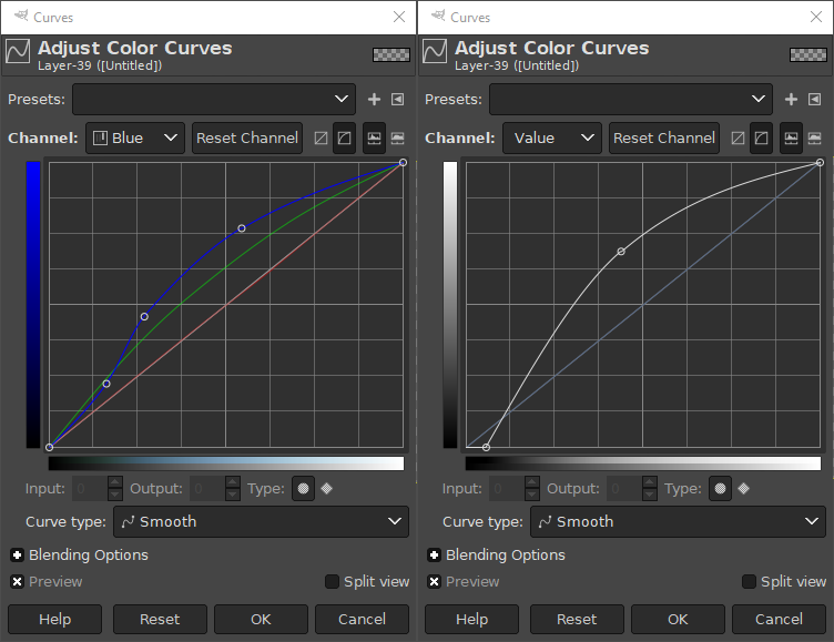

Using Screen mode is a quick and easy way to change the color from a darker shade to a lighter one.
But with curves it is also possible to obtain good results.
In the image on the right I used two curves, one on the original image, and the second on the result obtained previously.
I got an even better result by applying the Dark Only mode over the photo of the directory (obtained with curves).

sallyanne wrote:
I like that result krikor :)
Hi Sally,
Using screen mode; although easier, it may not always be the best option.
For lighter skin (or other objects / environments, etc.), the use of curves can give better results - Although it is always a matter of taste.
In the image below, from left to right *:
►Original image;
►Image with screen mode.
►Image using curves, in normal mode.
* Note: mask used to apply the change only to the skin.
