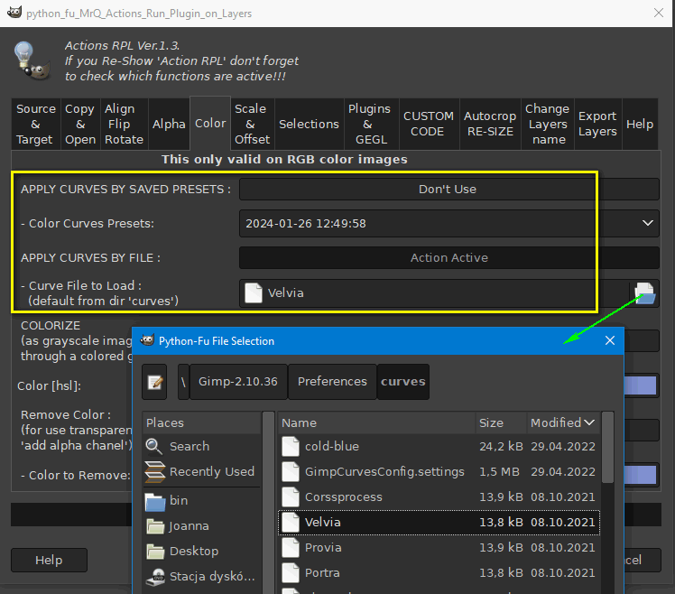

apply_curve by code Tin Tran:
viewtopic.php?f=9&t=14058&start=0
apply_color_curves_preset.py by code Tin Tran:
viewtopic.php?f=9&t=14064&start
My way of using it:
https://www.gimpscripts.net/2021/10/mrq ... s-rpl.html

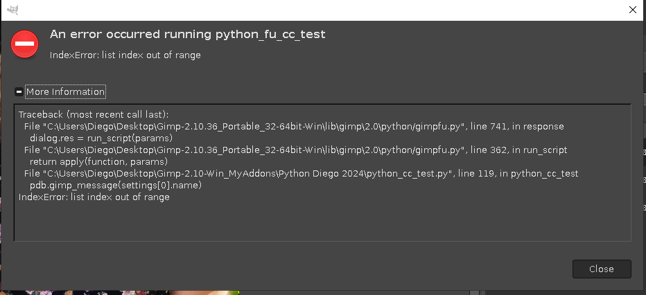

Sorry Tin and Ofnuts.
- if I copy what you posted (included ofnuts' suggested change) I get a list of messages, but nothing else
- whatever I add in the code, for instance create a new layer, it is executed but then no more filter messages but an error
As long as my little brain does not see at least one curve applied to an existing image I can't try to use the proposed flow.
You too Tin says: does not work on existing image, which is what I need: apply a curve to the input layer.
Thanks a lot for trying.
 Post subject: Re: use of a color curves preset in a python filter
PostPosted: Fri Jan 26, 2024 9:51 pm  (#18)
Posts: 4561
can you share you code?
it looks like it's not reading the file.
Update:
I think instead of
settings=load("C:\\Users\\tintran\\AppData\\Roaming\\GIMP\\2.10\\curves\\GimpCurvesConfig.settings")
with ofnuts piece it's should be.
settings=load(os.path.join(gimp.directory,'curves','GimpCurvesConfig.settings'))
