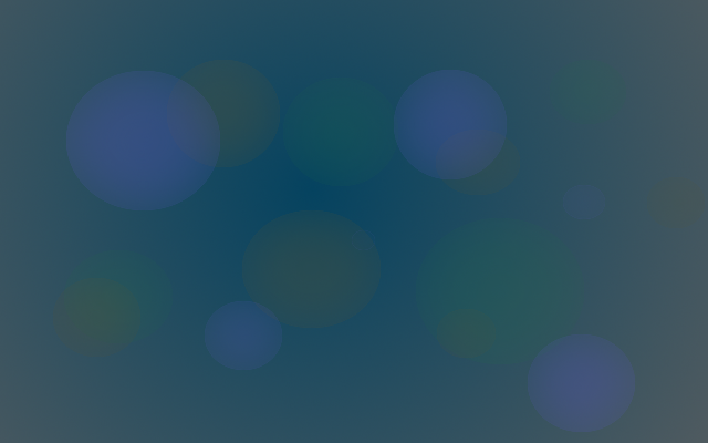

I attached an XCF to help you further - for each ellipse i blurred/Gaussian blurred to 76 or so.
Each layer also has a different opacity setting.
A neat trick to remember is to hold down the shift key while creating your circles...you can do them all this way at the same time.
