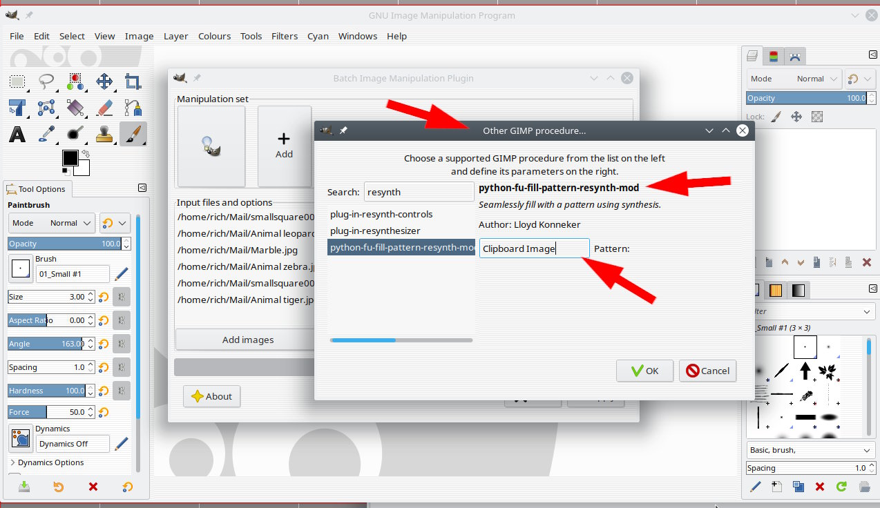

However, I modified that Fill with pattern seamless plugin to resynthesize the small pattern to a larger canvas (400 x 400) and make it seamless. Unzip attached file, Put it in your User Profile plug-ins folder.
Looks like this: https://i.imgur.com/bv4wqWh.mp4 Remember to export to another folder to save the original.
For batch then use BIMP Find that modified as 'Another Gimp procedure' Add the pattern name as Clipboard Image Add the files and output location. Not very quick but gets there.

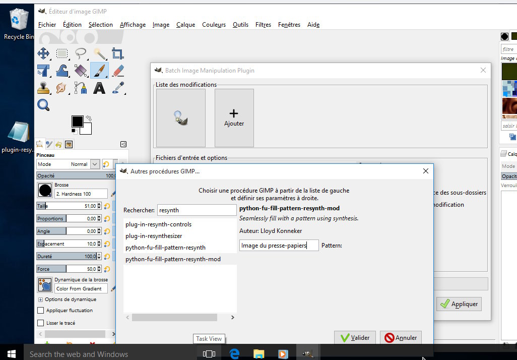

Language problem: Clipboard Image = Image du presse-papiers
that needs adjusting in the plugin-resynth-fill-pattern-mod.py file; Modified version attached
and in BIMP the 'other gimp procedure looks like this.

That looks to me that (1) You are using the English version of Gimp (BIMP & message is in English) and (2) the French version of python-fu-fill-pattern-resynth-mod
Use a matching pair, all French or all English
Also it does not matter where the pattern files are, Use the BIMP Add Images button.
Then depending if you are using the English Gimp + en plugin and in BIMP use Clipboard Image (note the capitals)
or
French Gimp + fr plugin Use Image du presse-papiers look at the earlier screenshot.

If it is any help this demo using samj Gimp - French launcher and the french version of that resynth plugin
https://youtu.be/SFLDhJgL1Pc 3 minutes - no commentary (my French is from schooldays more than 50 years ago ;)
