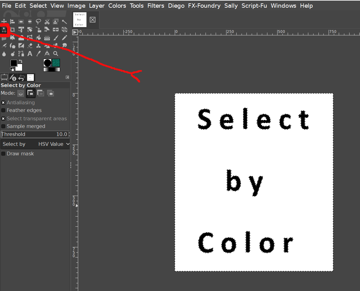

Did you try "Select by Color"?
 Post subject: Re: Use of Fuzzy Select tool to remove white background from black tex
PostPosted: Mon Mar 01, 2021 11:32 am  (#3)
If you choose that one, after you have the selection it's normally useful to grow the selection by 1
