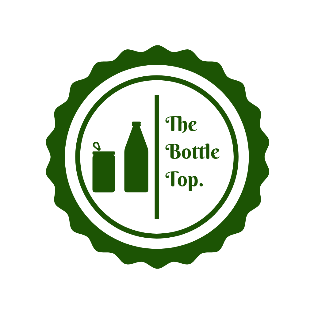

Hi. I'm trying to remove the white background around this logo to leave a transparent background, but leave the white inner, so I'm just left with the wavy lined "badge" which is green and white - if that makes sense.
I've tried things like Tools > Selection Tools > By Color Select, and Colors > Color to Alpha... (and then deleting the white), but I can't see how to "deselect" the inner white parts that I want to keep. Is there a way to do this without manually tracing around the shape?
Thanks!

Firstly ensure that the target layer has an Alpha Chanel; if not right click on the layer and select Add Alpha Chanel. Then I would just use the Fuzzy Select Tool and click on the white background you want to delete. Then grow that selection by 1 pixel and either clear it by pressing the Delete key or uses Colors>Colors To Alpha with the default white parameter. In either case you should end up with the green and white badge on a transparent background.

OMG has got it! Don't use the colour by select :colsel Use this tool :fuzzsel

If the green is solid on the edges, an easy way to do it is select> by color on the green, then select>invert selection, then use the erase tool to erase outside the green, leaving the white on the inside.

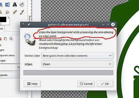

Another way, removing the need to shrink a selection, which removes the anti-aliased border pixels and leaves 'jaggies'.
Remove all the white then paint it back in ;)
Use color-to-alpha (c2A) to remove all the white.
Paint the white center back in (carefully) using the brush tool in 'behind' mode.
Comparison of fuzzy-select + grow selection and C2A 1 minute animation (Gimp 2.8) https://i.imgur.com/GHA8fS1.mp4
Edit: If you have lots of these to process and the 'hands-on' approach is time-consuming then there is a plugin that can help ofn-erase-background.py
http://sourceforge.net/projects/gimp-to ... s/scripts/ down the list ofn-erase-background.zip dated 2018-03-31.
That will keep that anti-aliasing.
