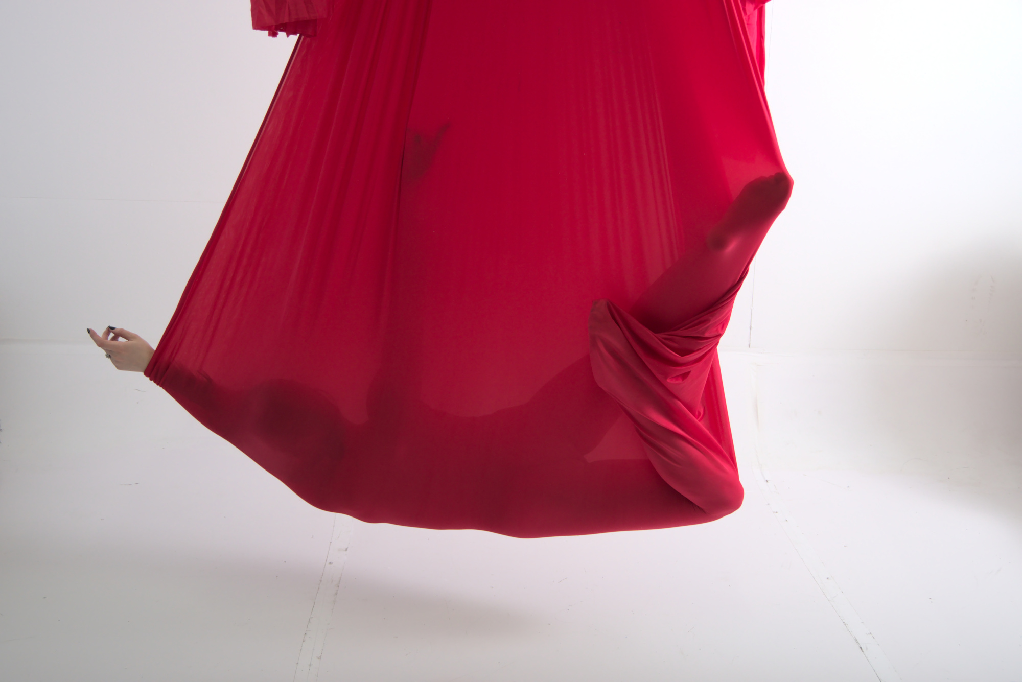

Looking for assistance from more experienced GIMP users: I'm trying to figure out a way to increase the translucence of the material this model in laying in. I've heard of this being done, and I specifically aimed my strobe behind the model hoping that the backscatter would eventually help the process, but I'm not even sure where to start. I have the original RAWs, if that helps. Any assistance will be appreciated. Thanks.

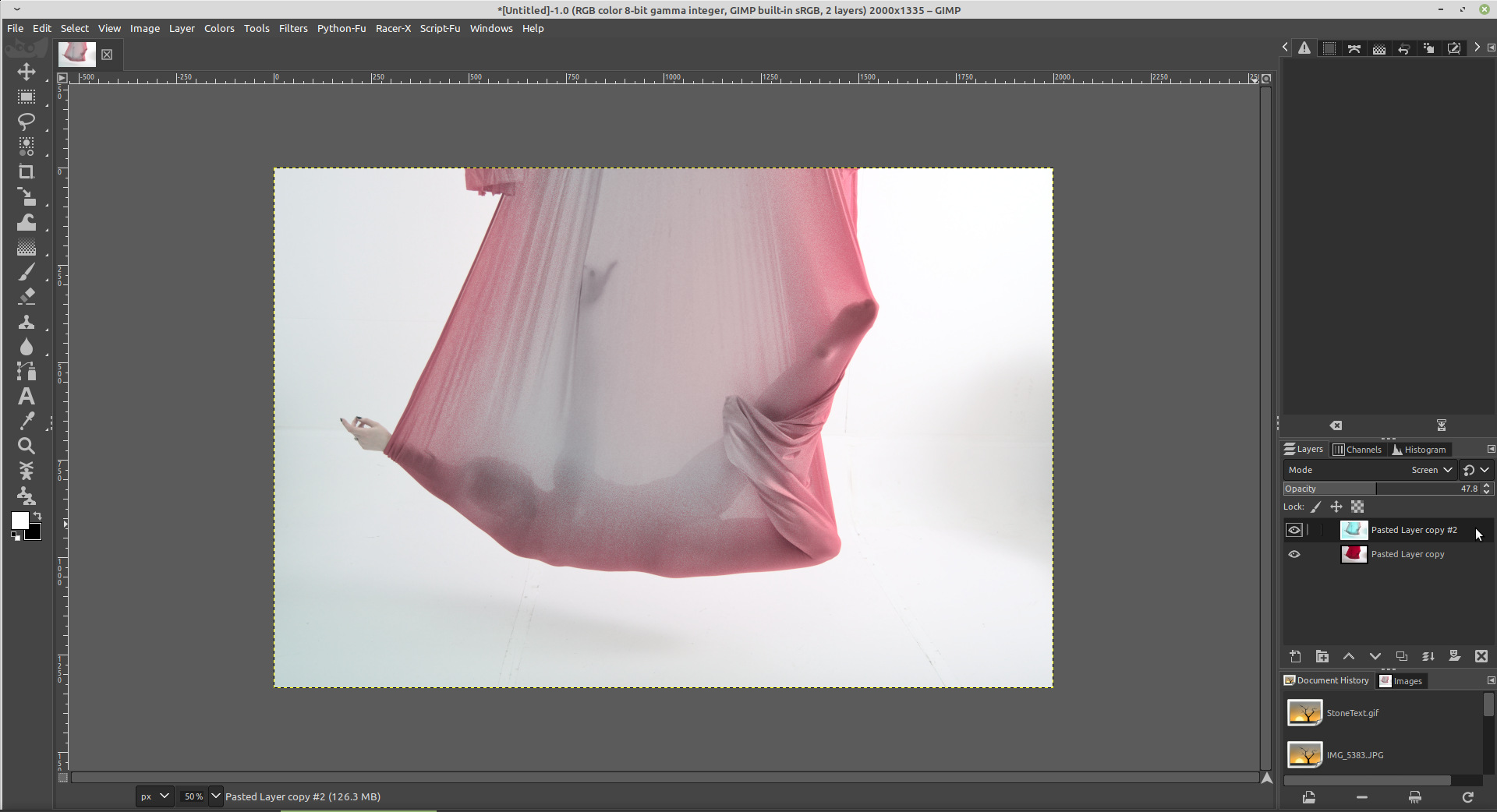

Impossible to create data that isn't there. About the best you can do is duplicate layer, convert layer to B/W and overlay using "Screen" blending mode, then adjust opacity to suit.

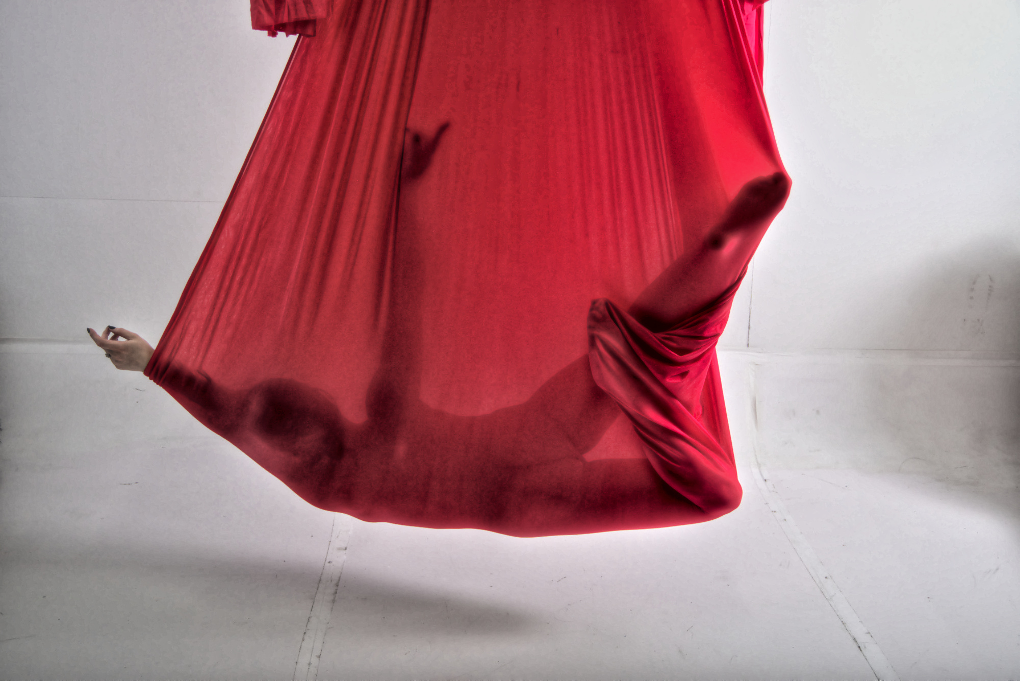

Selectively applied Freaky Details and reduced the red in the silk area for this result. Could use a bit more refinement/cleaning, but oh well. :)
