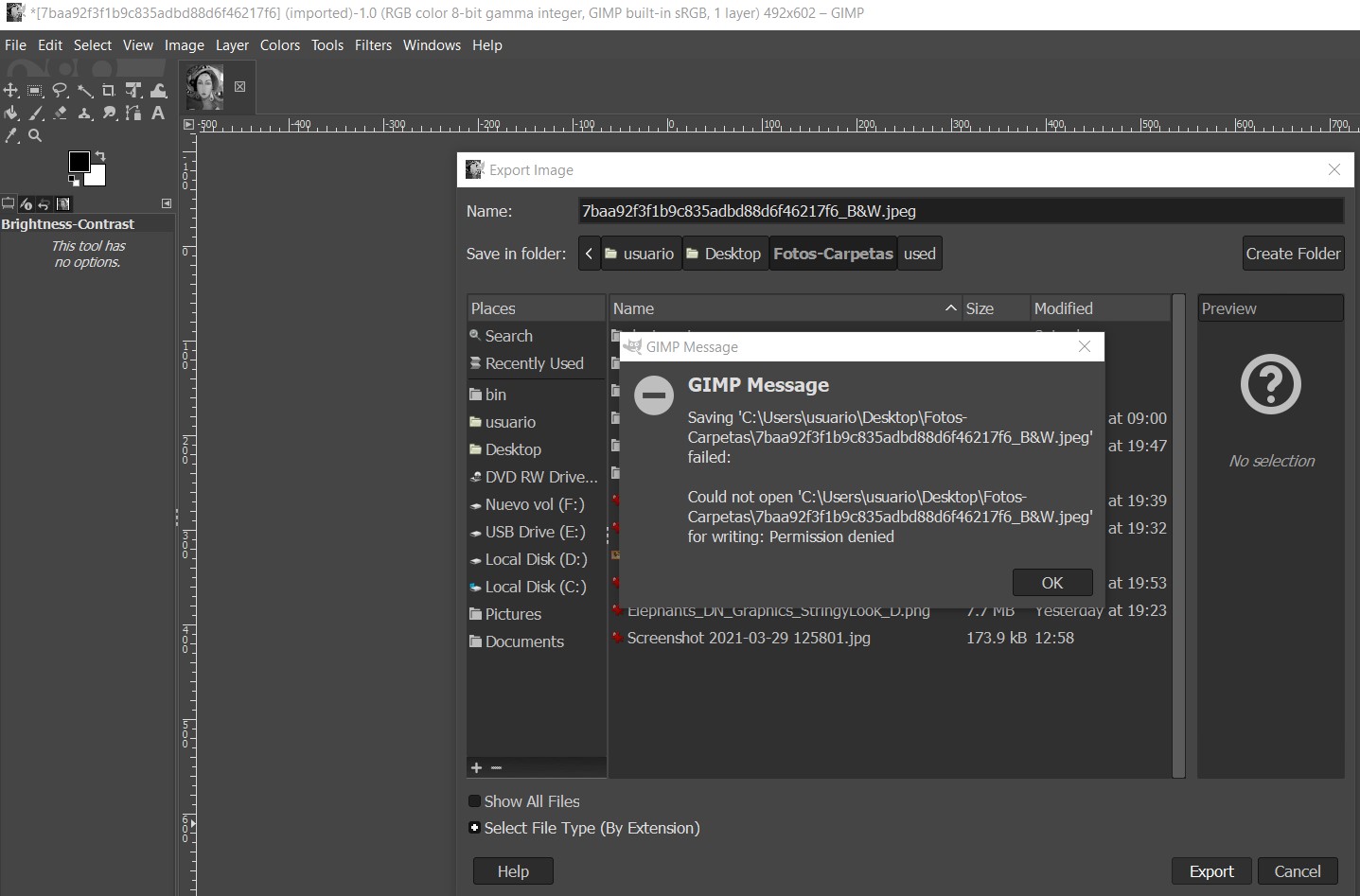

The problem started after PC system re-installation, I have this problem in Gimp and I don't know how to solve it.
I have installed Samj's package 2-10.23
Please I need your help if you can give me a guide or tip to solve it.
when I go to save a photo in jpg (ext) I have a notice of no permission.
when I save the same photo with png extension then there is no problem and I can do it.
What can I do to solve it?
Thanks a lot.

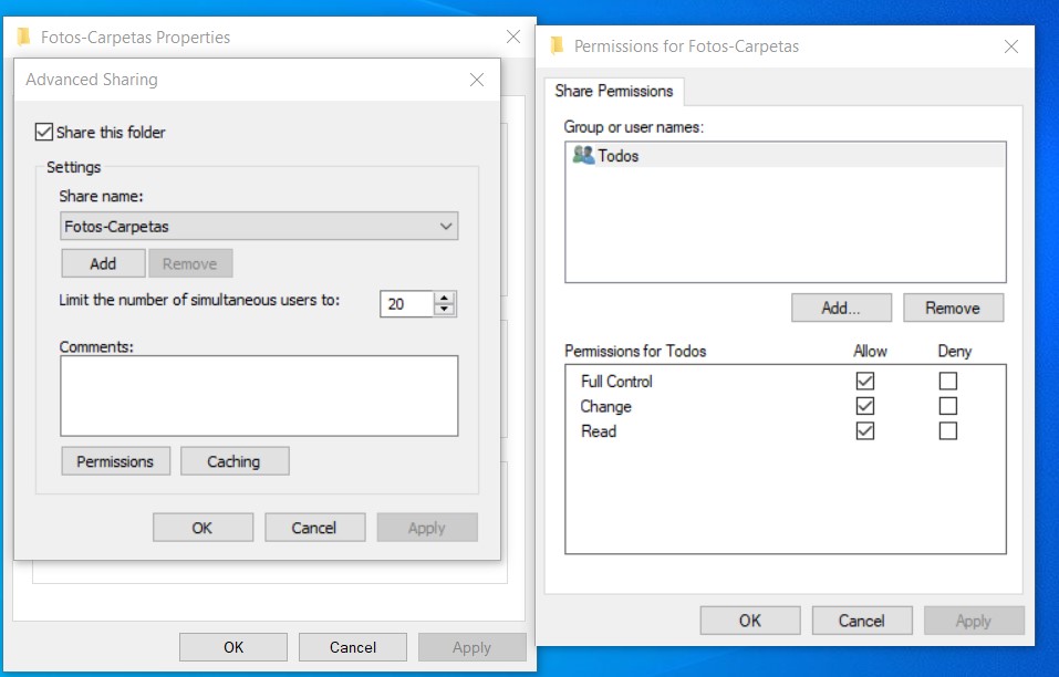

PostPosted: Mon Mar 29, 2021 12:45 pm  (#8)
Posts: 14105
No luck, I did what you said to me, but it doesn't work.
I think that the problem is based mainly in extensions of image. (png yes but jpg not)
Thanks a lot.

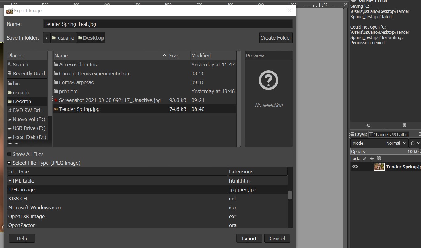

PostPosted: Tue Mar 30, 2021 2:44 am  (#9)
Posts: 14105
I can add a bit more information about the problem I have about extesions saving an image.
I can always open a .jpg image, modify it and to save it as .png and also as .gif (no problem those two extesions)
But I can't open an image modify it and save it in JPG or JPEG extensions.
Or simply, open a image jpg and save it without doing something in it
It's really a problem because any image in png weights a lot. I don't know what is wrong.
Please, if someone can give light to this, it'd be very appreciated.

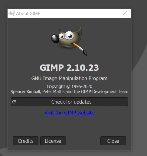

Posts: 14105
Thanks Dinasset. I saved the version I had in an external disc so that to install it after fixing my PC.
I have this vesrsion
