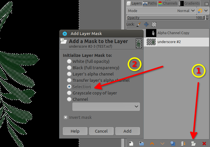

OH I GET IT! LOL, THANK YOU I JUST NEEDED TO CHECK "FROM SELECTION" WOW :tyspin :tyspin :tyspin
First thank you so much and so fast! ok, on the last step, i dont have that option in my list:

i dont have that option in my list: Yes you have, but wrong list (although you have it in your list, see screenshot below mine) :mrgreen:
Click on the icon number 1 (add a Mask in layer dock, window dialogue opens)
Then select number 2 (from selection)
And in your list :hehe :hehe
