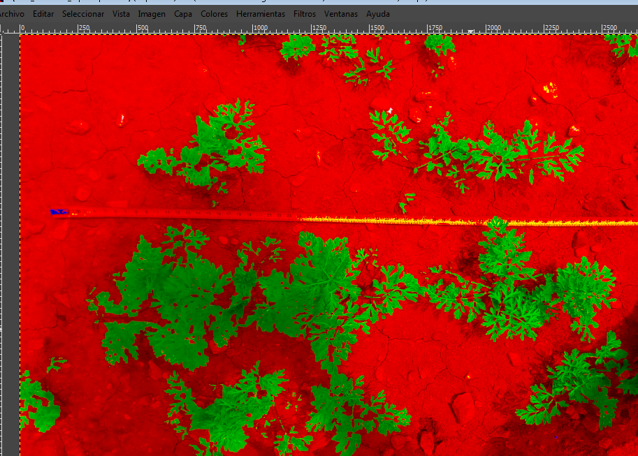

Hi everyone
I am new to the forum, sorry in advance if this is not the appropiate forum to ask this question, also I have done a quick search before asking with no results ¿?
I am an agronomist and have been using GIMP previously to determine percentage of soil covered by the crop canopy using crop-pictures taken from above
For that I used the RGBmax filter which "For every pixel of the image, this filter holds the channel with the maximal/minimal intensity. The result is an image with only three colors, red, green and blue, and possibly pure gray." (I originally linked to GIMP 2.6 help page plug-in-max-rgb.html)
Once this fiter was applied I could eliminate the red and blue channels and measure the amount of green present in the picture, from then on the proccess to obtain the percentage of soil covered by the crop was quite straight forward.
In the new 2.10 version most colour filters have been removed (seen at the GIMP version history for 2.10, "Color tools" section) and I lack the knowledge in this subject as to find a proper alternative using the current version.
Can anyone give me a hint as to how to solve this problem?
Many thanks in advance

Maximum RGB is still there, it is one of the filters that have been removed from the menu structure but retained for some backward compatibility.
Use the forward slash key ( / ) to bring up the Gimp 2.10 search option, type in rgb, look for maximum rgb, click on it to open the filter.
30 second example : https://i.imgur.com/xNKWF7g.mp4

:gimp
Thank you!, I feel in debt now, if you ever come to La Rioja in Spain I owe you a wine
File comment: I've managed to do it!
