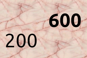

4 layers @ 600 = 2400
4 layers @ 200 = 800
Lowest common timing factor is 200 so you need 2400 / 200 = 12 layers @ 200
That is 3 cycles of the 200 animation merged with 1 cycle of the 600 animation. That is 12 layers of the 600 animation @ 200 (layer 1 x3 + layer2 x3 + layer3 x 3 + layer4 x3)
Then the background layer added to the 12 layers.

I do not think it is as easy as that ;)
Mind Blown! See .... math :/
