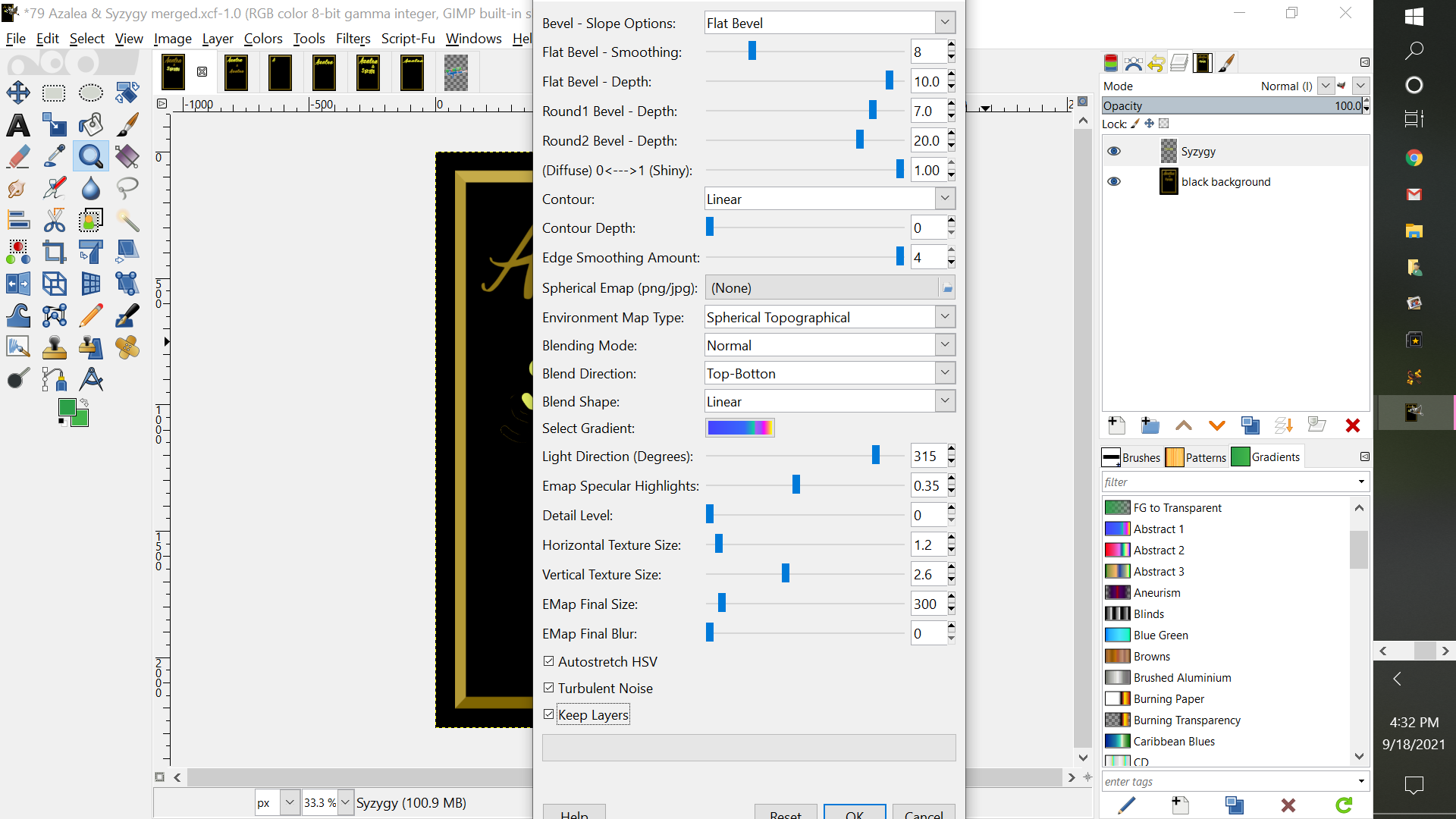

Yes, mine is too big for the Windows screen. As you can see, I can't reach the Okay button at the bottom.

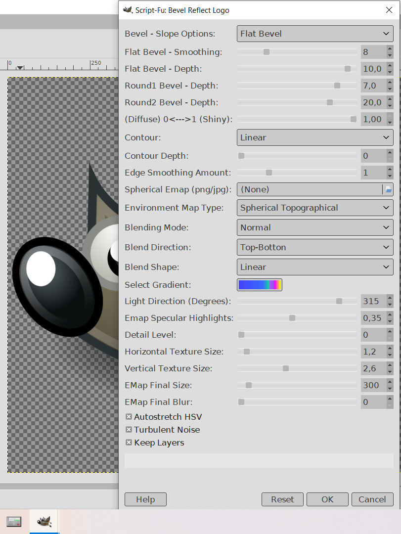

Yeah... I can understand your frustration, that "OK" below.... I'm on Linux so I don't care as I can drag it up, but still... :roll:
In all case I don't know if it's possible to make some "tabs" like in the MareroQ's BoxText viewtopic.php?f=9&t=19519 as it is an .scm and not a .py
Anyway, a kind of good news:
There is another "Bevel Reflect Logo" where the list of settings is a bit shorter, thus letting you access to the "OK" button (and you have access to a map)
I don't recall where in the original it is as I changed the path (to have my plugin organized my way in the GIMP menu), but to access it in GIMP
FIRST open a document or create a new
You do need to type your text, then right click on it > "Layer to image size" (important)
Then hit the forward slash "/" in GIMP (or go to "Help/Search and run a command")
Then a box dialog opens and enter "bevel" a list auto update below while typing, double click on the one which is written below "Create Selected Logo"
You should access the "OK" button on this one (you might need to drag up the window but there is space to do it ;) )
Someone can give you the original path via the GIMP menu to find it instead of each time calling the search
Patrice

Pixlab--thank you for your advice. It did indeed get me a new BRL box that I can see more on --If I use my mouse to drag the box upward as far as it goes, I can now see the top of the OK box all hotted up ready to be clicked but... not enough. I can't reach it! There's not enough of it showing. So near and yet so far!! Thanks again.
I'm using 64.
Wow.. so you can see it (even partially) but you cannot click on it... I'm very surprised (might be a thing of Windows...)
Let's try something else ;) => still the same process than previously in my post but this time
Try with the [Tab] key on your keyboard, I mean the tab key is something in GIMP**, so you do need to "highlight/put it in focus" that BRL's window, input your setting in (or click on the top bar of that window to "highlight/put it in focus" it) then when you want to "OK" move the selection with the tab key until you arrive to the "OK" button, then hit the "Enter" button on your keyboard once you see the "OK" button is selected ;)
**note: If you see all your tools and tabs disappear it's normal :yes , the Tab key is a toggle switch to give more space to your drawing, just hit the Tab key again and everything will get back normally (and put that BRL window in focus to not happen ;) )
