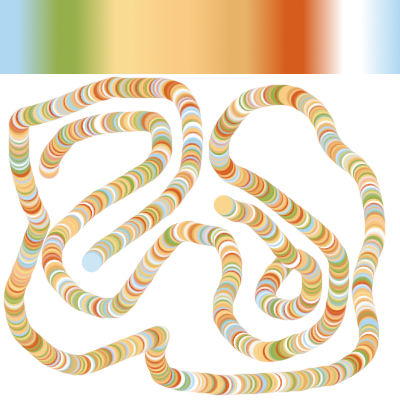

Color sampled at random in the current gradient....
