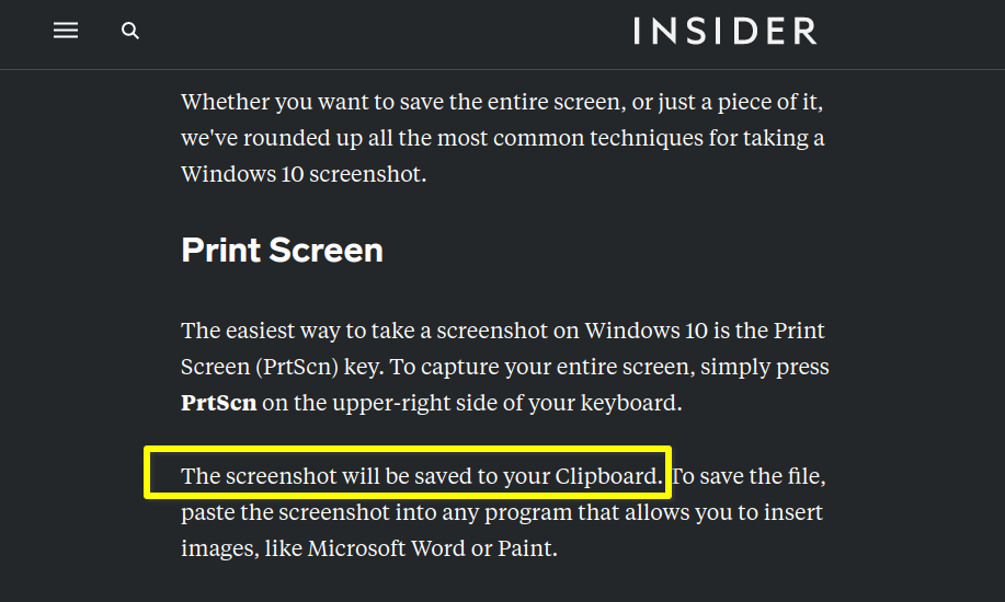

I find print screen is quicker and then you can edit it to how you want, after Printing Screen 'paste as a new image' in Gimp.

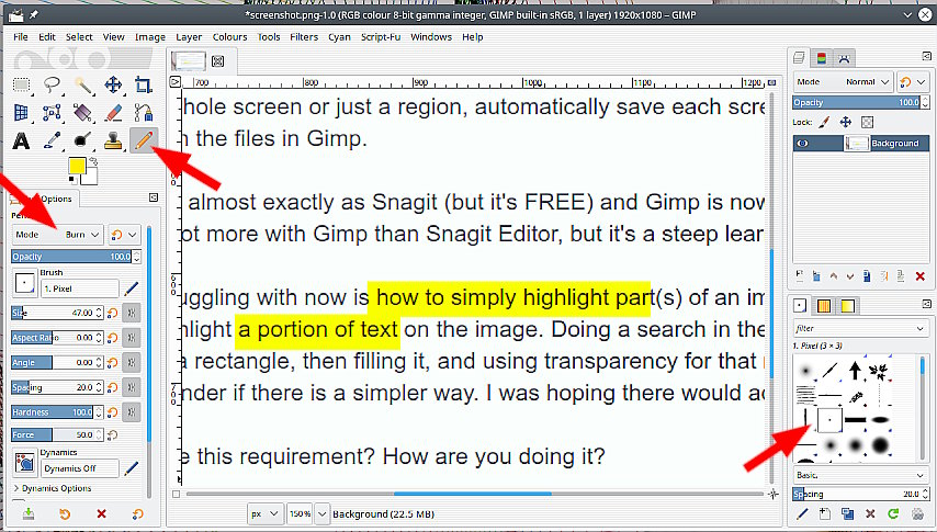

One thing I'm struggling with now is how to simply highlight part(s) of an image. My main use case for this is simulating using a yellow highlighter to highlight a portion of text on the image. Doing a search in the community on this resulted in some hits showing how to do it by drawing a rectangle, then filling it, and using transparency for that rectangle. I haven't gotten that to work perfectly yet, but even if I did, I wonder if there is a simpler way. I was hoping there would actually be a highlight tool.
Anyone else have this requirement? How are you doing it?
 Post subject: Re: Using Gimp for screen captures
PostPosted: Mon Mar 08, 2021 10:55 am  (#8)
Posts: 2615
All depends on the image but for regular black text on white then suitable brush and size-to-suit / pencil tool / Mode = Burn in the tool options. Click, hold shift, move tool pointer, click again for straight lines.
Experiment with the tool modes.

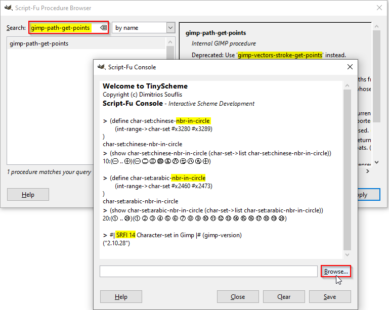

 Post subject: Introducing HighlightText.scm 1.0
PostPosted: Thu Nov 11, 2021 8:44 am  (#9)
Joined: Oct 23, 2021
Posts: 67
Hello IMZvonko
According to the rich2005's solution above, if you choose a circular brush of the size of the height of the text, you can burn the background in yellow with a rounded corner-like effect at the beginning and the end of the straight line drawn by :pencil
Let us suppose that you do not wish to change the current color of the pencil or the brush.
  1. Click the Rectangle Select Tool :rectsel
  2. Check (or not) the option [x] Rounded corners in the Tool Options
  3. Select the text to be highlighted in the image
  4. DbClick the Gimp menu "Highlight" at the right of the "Help" menu
The text "Greenshot" has been highlighted by Greenshot with a rectangular selection.
Other yellow highlighted texts have been emphasized by Script-Fu HighlightText.scm :mrgreen:
HighlightText.zip [1.65 KiB]
Downloaded 290 times
  1. Download the zipped archive HighlightText.zip 2KB
  2. Unzip HighlightText.zip to generate HighlightText.scm 4 KB
  3. Optionally read MIT-like licence minus commercial use at the end of the .scm
  4. Copy HighlightText.scm in C:\Users\YourUserName\AppData\Roaming\GIMP\2.10\scripts\
  5. Restart Gimp
:arrow: The Gimp menu "Highlight" should appear after the "Help" menu.
Let us comment the main lines of code in Script-Fu:
IMZvonko wrote:
drawing a rectangle
let* defines the local variables:
Let us retrieve the rectangular selection: :rectsel
(boundSel   (cdr (gimp-selection-bounds image)))
LAYER-MODE-MULTIPLY will burn the background.
(layerHiT   (car (gimp-layer-new image widthSel heightSel RGB-IMAGE "HighlightTxt" 100 LAYER-MODE-MULTIPLY)))
in yellow: :paint
(gimp-context-set-foreground "#ffff00") ; yellow
IMZvonko wrote:
then filling it
(gimp-edit-bucket-fill-full layerHiT BUCKET-FILL-FG 0 100 0 FALSE TRUE 0 0 0)
(gimp-drawable-fill layerHiT TRANSPARENT-FILL)
Related topic: Gimp menu "DX" > "Highlight selected area..."
github: DX Screenshot
Fix the original condition that displays a warning:
(if (= (or draw-border fill-area) FALSE) (gimp-message "Nothing to do - check 'Draw border' and/or 'Fill area'."))
by:
(if (and (= draw-border FALSE) (= fill-area FALSE)) (gimp-message "Nothing to do - check 'Draw border' and/or 'Fill area'."))
TRUE is the numeric value 1 but not a boolean: :huh
:keybdtype Copy and paste in the Script-Fu console then validate by the 'ENTER' key.
(or FALSE TRUE)
;-> 0 is displayed by the Script-Fu console
Disjunction of opposite boolean values: :geeking
(or #f #t)
;-> #t

Also I just learn that on Windows OS when you hit the "PrintScreen / PrtScr" key, Windows copy it to the clipboard (yeah.. I needed to do some searches -> I'm using only Linux)
In the end why all those copy/paste and back and forth between greenshot and gimp?
Why not Highlight directly in GIMP as the OP asked?
Hit that "PrintScreen / PrtScr" key = clipboard, then in GIMP > File/Create/From clipboard, then >> New layer in multiply mode >> make your selection >> drag n drop the color from FG or BG >> DONE! and this method can protect from mistakes as well...
Or use the brush as suggested by @Ofnuts, big advantage of Ofnuts brush, you got a preset that you just call once and highlight as many time as you need just with a brush, also next time when you re-open GIMP it's there and accessible in just 1 click.

  • No script needed for that >> Just drag n drop the FG or the BG color on the image...
    Oh you DO NOT EVEN NEED to drop it in the selection as it will fill ONLY the selection and if you use the multiple selection mode (addition/add) it will fill all at once, :bigthup

    It's amazing how around twenty tiny lines of Scheme could generate as secondary effects.
    PixLab, AlSchemist particularly appreciated the pythonesque quote of the movie! :evilgrin :sfight :sword
    Into the bargain, you mentioned about ksnip the key feature of auto-numbering enough interesting also in GreenShot.
    Ten years ago, Silas Silva created mark-number-circles.scm in github under GNU license.
    In the 2021 version, some original "TODO" have been fixed by AlSchemist.
    mark-number-circles.zip [2.24 KiB]
    Downloaded 277 times
    Usage:
    1. After unzipping, copy mark-number-circles.scm 5 KB in C:\Users\YourUserName\AppData\Roaming\GIMP\2.10\scripts\
    2. Restart Gimp
    3. Draw two or more points with the Paths Tool :pathtool
    4. Click the Rectangle Select Tool :rectsel
    5. Gimp menu "Filters" > "Render" > "Mark Number Circles"
    :arrow: Each point of the path will be replaced with a incremented number inside a circle.
    Hereafter enclosed is the process of migration in Gimp 2.10.28 because in the decade, some API were deprecated.
    The original gimp-path-get-points is "deprecated: Use 'gimp-vectors-stroke-get-points' instead." says PDB aka Gimp Procedure DataBase.
    The old API generated a longer vector translated into a list, hence:
    ; Other itens are repetitive for us, so drop it.
    (set! lis (drop lis 9))
    About the drop function, Silas indicates:
    ; Quick (and dirty?) implementation of the drop function of SRFI 1 extensions to Scheme,
    ; not implemented in TinyScheme (the interpreter used by Gimp).
    ; It drops n elements of the list and returns the rest.
    It is the very first time that the abbreviation SRFI 1 standing for Service Request Feature for Implementation is ever written in GimpChat.
    Hope that AlSchemist will be not burnt alive on the stake for this taboo.
    That is why the function drop of SRFI 1 has been dropped in the 2021 version of mark-number-circles.scm.
    After all, for numbers in circle, there is SRFI 14 Unicode Character-Set.
