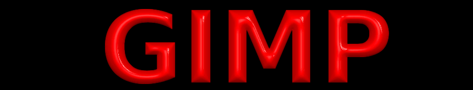

Paths are your friend. I used ofnuts bend path plugin to achieve this on two different sized texts.
