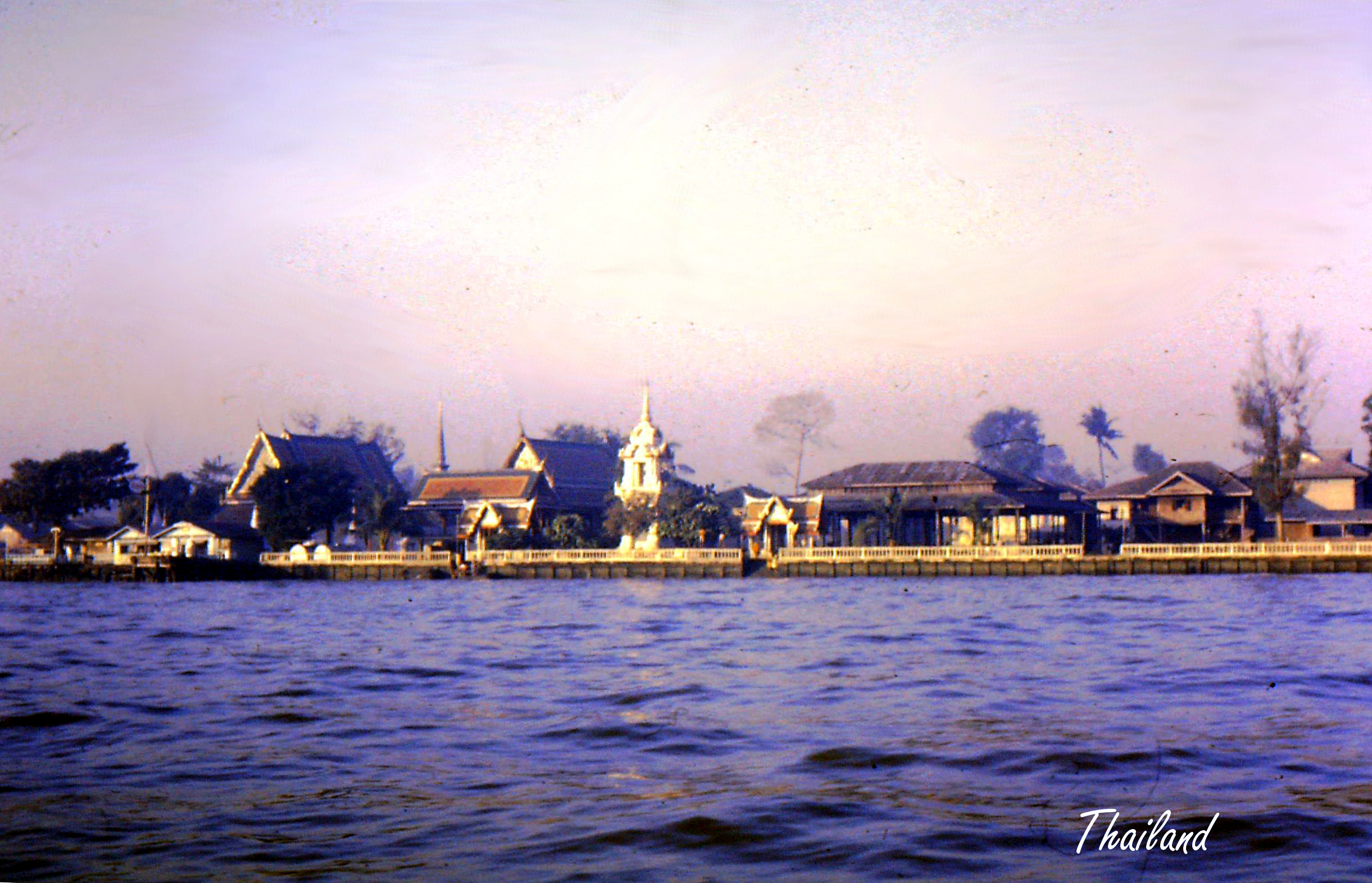

I'm digitizing a bunch of old photos for my parents. For some reason the 'sky' is gone in several images, in others of the same vintage it is fine.
My question is: is there some method or script that can show the value of images? When I make a layer mask to replace the sky, it sometimes looks very fake. I have gotten the shadow direction down and even had some success with desaturating the sky image. I'm just thinking there has to be a better way and the brains here probably have seen/done this before.

I loaded one up. Circa 1970-71. Notice the sky is 'gone' but rest of image is OK.

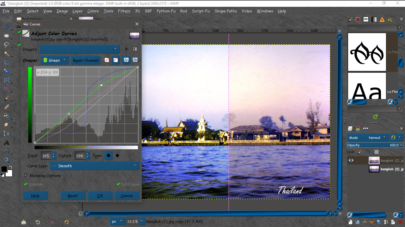

Just playing with Colors>Curves on a duplicate layer can bring some sky back and brighten the image a bit. Just value, blue, and green. I didn't mess with the red settings. ;) :bigthup

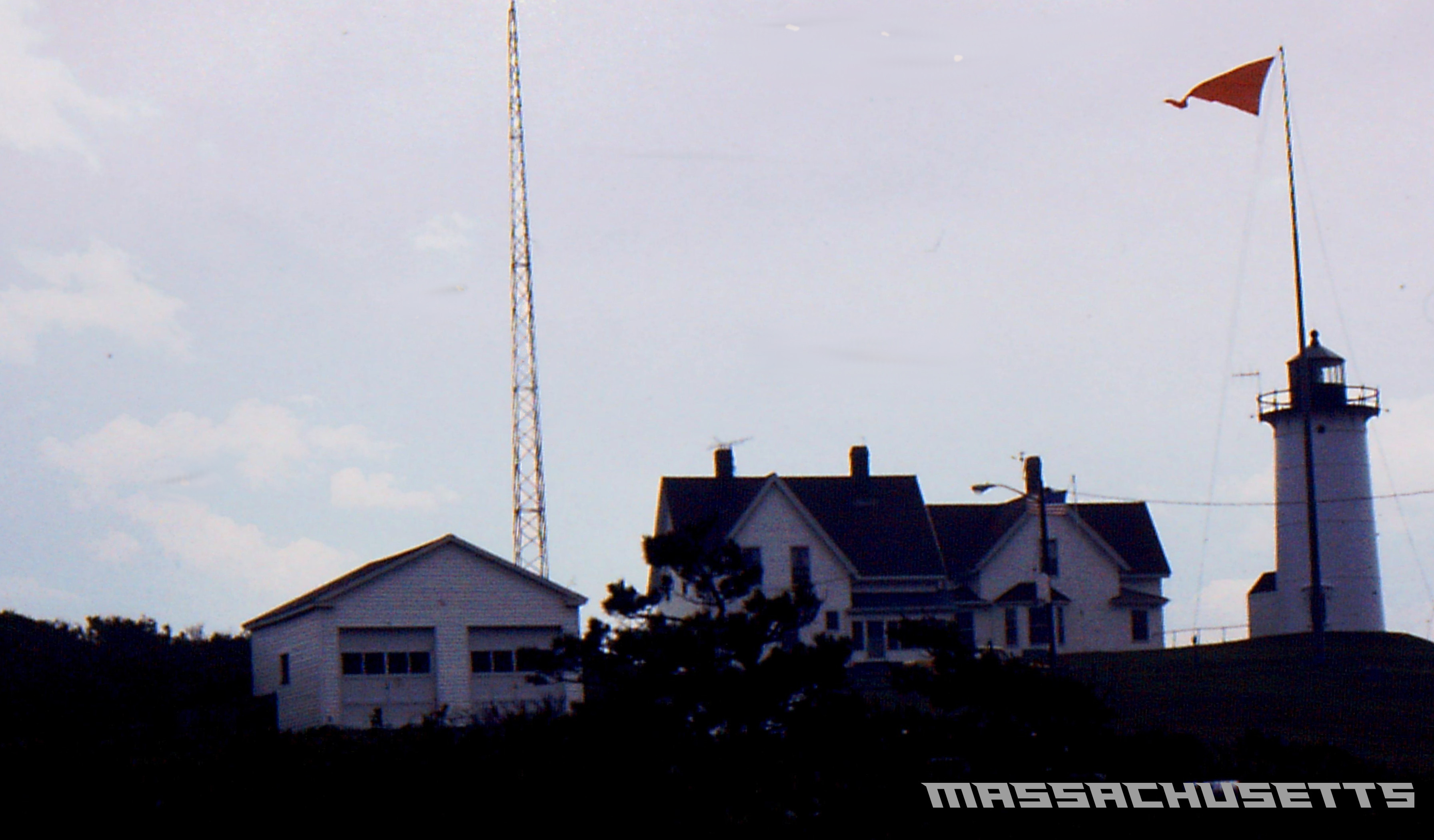

The example given was not the best---laziness on my part. I just selected the first image that came up. I have uploaded anther example.

Masks and curves will get you most of the way there, but it can't overcome incorrect exposure....
