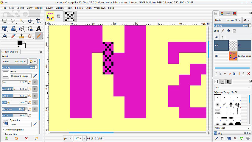

If you need a X in a single pixel then that is not possible. An X shape is made from several pixels. the smallest useful size is a 5 x 5 grid. So your 50x60 image needs to be 250 x 300 pix

You can't add an X on a pixel, because to be seen as an X, the shape would require several pixels.
You have to scale up your image 8x or more (with "Interpolation: None" so that you get square pixels and not a blurry mess.
Then you create a small X brush, and use it paint on the squares

* You create a 8x8 grayscale image, on which you draw an X (using the Pencil) and the "Pixel (1x1 square)" brush.
* "Select > All", "Edit > Copy"
* And in the Pencil/PaintBrush you select the "Clipboard mask" brush (2nd in list)(Pencil is preferable for what you want to do)
