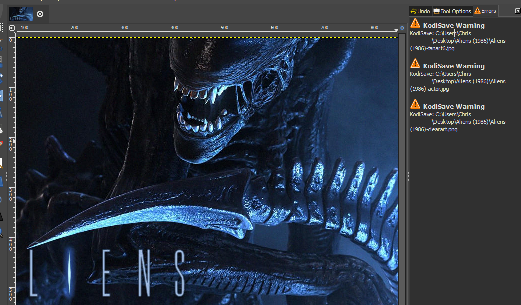

I am looking for a solution that can help me simplify creating media after i save an .xcf file.
I'm am doing "clearart" for my Media center files that use Kodi. It is a multi step process but the most tedious is exporting.
Is there a script or method that will allow for:
- When I save as file.xcf
- Invoke > File > Export As > file-clearart.png (Simultaneously....in the same folder file.xcf > automatic overwrite without warning)
I am 100% aware about accidental overwrites, but since the export is the caboose of the process...I don't care....and I have backups of all the old if it were a problem....and it is a function of....if I save it as the file.xcf then I want the .png of that save regardless.
Is there a way to make this behavior occur? I don't personally write scripts and I don't have the bandwidth to learn it now, eventually I will.
I have over 250 items to get through and it is going to take time. So I'm trying to minimize any keystrokes/mouse movements. I've allocated a lot of keyboard shortcuts for the creation method...but I can't seem to find a way to simultaneously save and export.
Is there a script already out there or a way to do this?

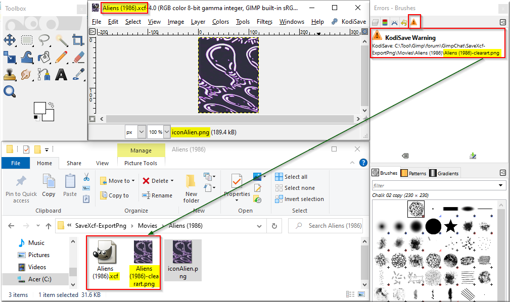

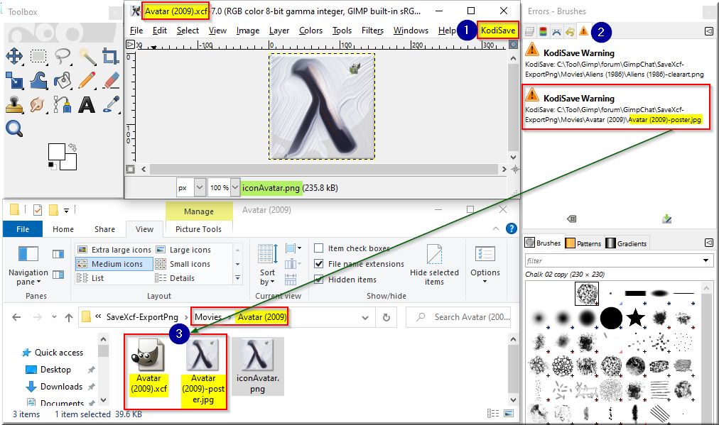

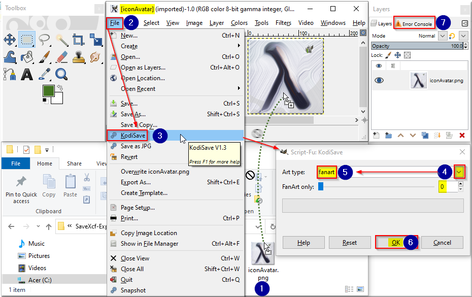

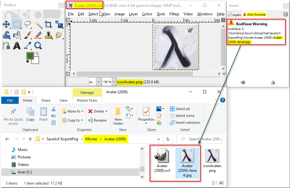

save_and_export.scm by Rob should solve the issue. :yes
There are two functions that will appear in the first menu "File":
  1. save-as-and-export
  2. save-and-export
when you will copy the Rob's script save_and_export.scm in your:
C:\Users\YourWindowsUserName\AppData\Roaming\GIMP\2.10\scripts
Replace "YourWindowsUserName" with your real UserName in Windows to find the real path.
Then restarts Gimp.
The new menus "Save XCF and export..." and "Save-As XCF and export..." are grayed by default
until you open a picture from your 250 items used by Kodi.
One will never know what is the file extension of these items. :roll:
The first function save-as-and-export should be used the first time to save as .xcf and export as .png.
The dialog box asks you the folder and the filename.
Check the option [x] Export a png and eventually uncheck the option [ ] Export a jpg.
The second function save-and-export is simpler since there are only the two checkboxes png or/and jpg.
This means that the picture has already been saved, that is to say the picture has a name.
The Rob's script saves .xcf and .png with the same basename in the same folder. :geek

Downloaded and used, does a good job, may tweak it for my application, but certainly saves some time. I'm already down to about 20 or so left, but will be helpful for future events.
The file extensions are nothing more than .jpg and .png.
All my movies are mp4 and the skin uses the images for a great presentation of the movie showing actors and the rest.
Not really sure why items is italicized, they are just background removed images with a transparent background etc.
Thanks for the assist.

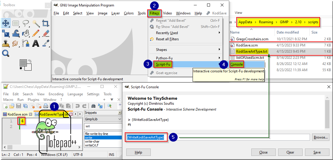

 Post subject: Vector of Kodi art types
PostPosted: Sat Apr 08, 2023 7:28 am  (#7)
Joined: Oct 23, 2021
Posts: 67
Introducing a vector of art types:
It is like a list but prefixed by sharp "#".
Vector is faster than list and item in a vector can be directly extracted by vector-ref.
By convention, the first letter in the name of a vector is the letter "v".
(define vKodiArtSuffix #("actor" "back" "banner" "characterart" "clearart" "clearlogo" "discart" "fanart" "fanartSharp" "keyart" "landscape" "poster" "spine" "thumb"))
vKodiArtSuffix
We can retrieve a particular art type as a 0-based index in an array:
(vector-ref vKodiArtSuffix 4)
"clearart"
Remember the list of picture ids returned by gimp-image-list.
(gimp-image-list)
(1 #(1))
It is a list having the number of pictures open in Gimp followed by a vector of picture ids.
Let us loop to display all art types.
To simplify, we group both the definition of the function DisplayAllArtType followed by its call.
The function displayln displays a text then returns to the line.
This function is defined in C:\Program Files\GIMP 2\share\gimp\2.0\scripts\palette-export.scm
(define (DisplayAllArtType)
   (let*   (    (artTypeMax (vector-length vKodiArtSuffix))
      (displayln "")
      (let loop ((idx 0)) ; starting 0-based index
         (if (< idx artTypeMax) ; Loop while the index does not reach the maximum
            (begin
               (display "art type ") (display idx) (display ": ")
               (displayln (vector-ref vKodiArtSuffix idx))
               (loop (+ idx 1)) ; recursive call incrementing the index of art type
(DisplayAllArtType)
DisplayAllArtType
art type 0: actor
art type 1: back
art type 2: banner
art type 3: characterart
art type 4: clearart
art type 5: clearlogo
art type 6: discart
art type 7: fanart
art type 8: fanartSharp
art type 9: keyart
art type 10: landscape
art type 11: poster
art type 12: spine
art type 13: thumb

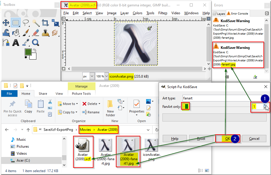

We can synthetize previous posts by the following function having img as parameter.
This function returns a vector composed by the path, the basename and the file extension of the image id "img":
(define (PathInfoPic img)
   (let*   (    (fullname (car (gimp-image-get-filename img)))

Creating KodiSaveArtType.txt for art type 4 = clearart
The new menu "KodiSave" is grayed at the right of the last menu "Help" while there is not any image in Gimp:
  1. In the same folder, you also need to create, for example with NotePad++, a text file called KodiSaveArtType.txt containing the number 4.
    It is the index corresponding to art type "clearart".
    Don't forget to return at the line after the number 4 on the first line.
  2. Alternatively, in Gimp menu "Filter"
  3. "Script-Fu"
  4. "Console"
  5. run:
    (WriteKodiSaveArtType)
    This will create the text file KodiSaveArtType.txt with the index 4 for you. :wizwand
The shortcut for Gimp menu "Filter" > "Script-Fu" > "Console" is ALt+R S C

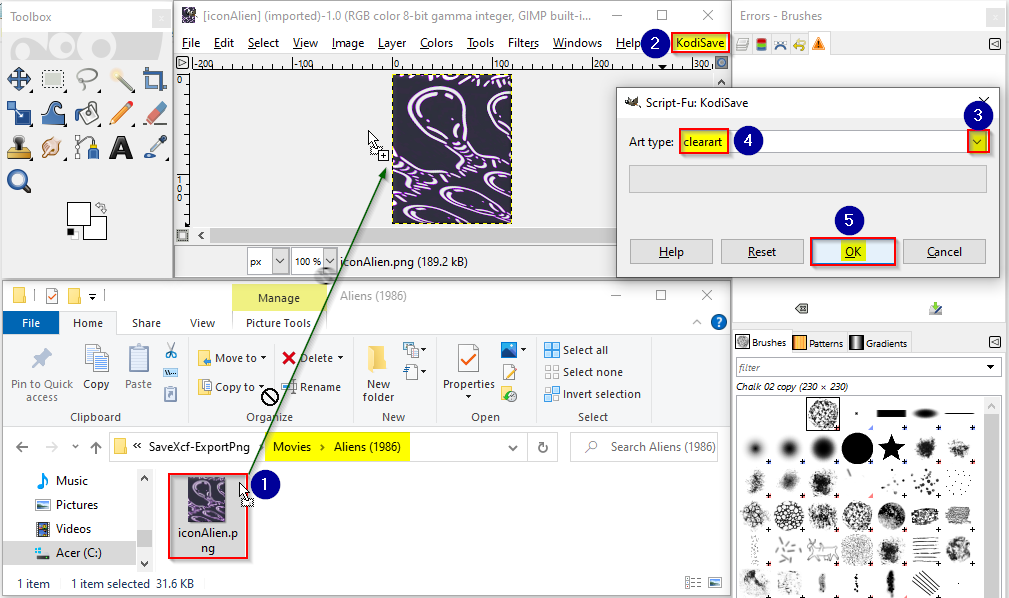

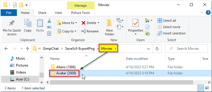

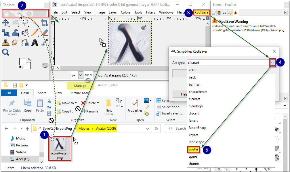

Save as .xcf and export as .png using the menu KodiSave
  1. Open or drag&drop your Kodi media .jpg or .png among your 250 items you wish to edit.
  2. Make your modifications in the different layers.
  3. Click the direct menu "KodiSave". The menu becomes blue. :blingbling
  4. Click again the same menu to effectively save the current image as .xcf and export as png according to the current art type.
:bugthumb

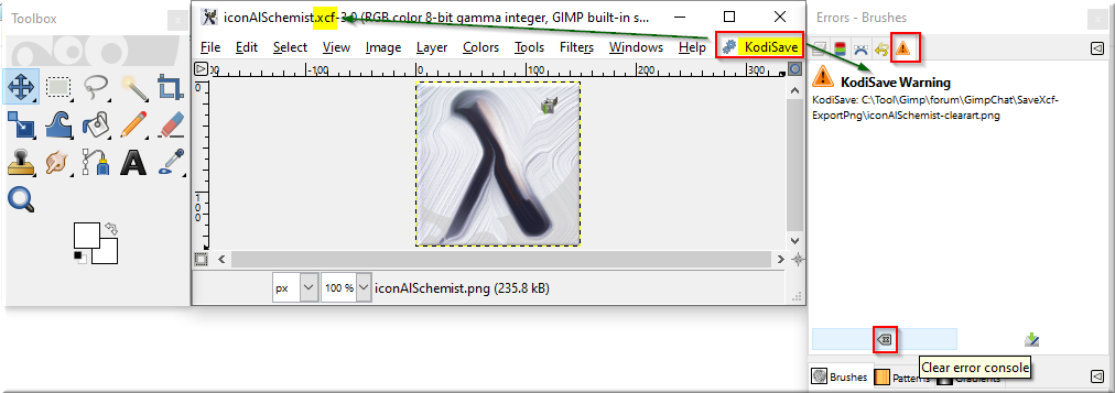

To accelerate the process of saving and exporting, there is not any dialog box of confirmation.
The Gimp status bar displays the full filename of the exported file with the art type suffix as .png :sglasses
Note that the saved .xcf is reloaded, then the layers are merged before exporting to .png

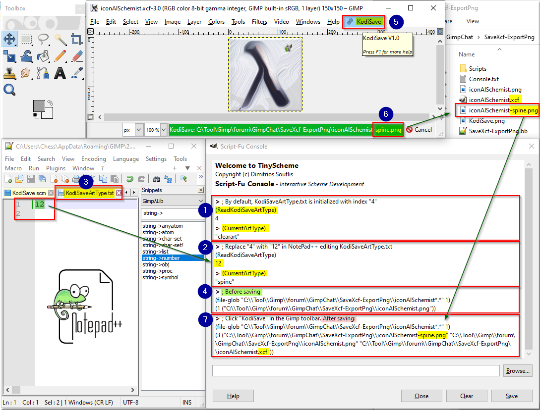

Changing the art type to 12 = spine
Let suppose that you wish to change the art type.
Just edit KodiSaveArtType.txt in NotePad++ changing the art type by default 4 by for example 12 for "spine".
You can edit KodiSaveArtType.txt at any time without reloading Gimp or selecting an option in a dialog box.
You do not need to open the Script-Fu console.
However, to explain the Scheme code, every function is called to demonstrate the expected result.
In NotePad++, the shortcut to capture a Scheme expression in parenthesis is Ctrl+Alt+B when you are on a given parenthesis.
  1. Let us recall what is the art type by default using:
    (ReadKodiSaveArtType)
    The result is the index 4 that we can convert in a name by:
    (CurrentArtType)
    displaying "clearart".
  2. You are asked to edit the art type.
  3. Go to NotePad++ and replace the old index 4 by the new index 12 in KodiSaveArtType.txt :keybdtype
    (CurrentArtType)
    displays "spine".
  4. The Scheme instruction "file-glob" is equivalent to "dir" in a Windows console or "Get-ChildItem" in PowerShell.
    So you can list the existing file before saving.
  5. Click KodiSave. :idea:
  6. Read in the Gimp status bar what has been exported.

I would also mention a creature feature to help eliminate mouse clicking and typing would be for the .xcf file and exported png/jpg to pickup/use the folder name...in which....should already be named movie/tv show (date) and construct filenames based on that with the proper index concatenated.
So if I was building a clearart file located in a proper movie name like: After Earth (2013)
When the export is ready, it would generate the files:
After Earth (2013).xcf
I was also thinking about the index 4, makes sense in this stage, a bonus would be when the save/export is called, that all of the art types are represented with checkboxes defaulted to FALSE and when you select a single only checkmark, it uses that checkmarks index to output the appropriate file naming convention.
I am looking at everything here and its a pretty sweet so far, thanks for the assist on this, it would have been very difficult to even get to where this is at now as I'm learning this from scratch. So thank you for your efforts.
Chris

I'm getting this error:
> (KodiSkinPath (gimp-image-get-id) (ReadKodiSaveArtType))
Error: eval: unbound variable: read-line
Using Windows 10.
TY.
 Post subject: KodiSave 1.1 + I/O read-line
PostPosted: Sun Apr 16, 2023 6:11 am  (#13)
Posts: 67
I forgot read-line from the I/O library powered by Richard O'Keefe in the Indiana University Bloomington repository.
Because this library is included with credits in my GimpLambdaLib 0ts-stdio.scm
So I removed my entire GimpLambdaLib to keep only KodiSave.scm version 1.1 pusblished in GimpChat page 1.
read-line has been added at the end of this script. So you do not need to install the GimpLambdaLib.
I found that the Gimp status bar is very volatile. :shock:
The KodiSave message is often overwritten by any other messages if the user moves the mouse pointer.
So, in 1.1, the KodiSave message is also displayed in the Error console even if it is not an error.
To open the Gimp Error console, click Gimp menu "Windows" > "Dockable Dialogs" > "Error Console".
KodiSave will display its message of export in a persistent way until you clear the Error Console. :hi5
I will analyse your detailed requirements #10 and #11 soon.

 Post subject: KodiSave 1.5 with art type dialog box
PostPosted: Sun Apr 16, 2023 1:54 pm  (#14)
Posts: 67
KodiSave 1.5 with dialog box for art type = clearart
KodiSave 1.5 with dialog box strongly simplifies the Scheme code since the text file KodiSaveArtType.txt is no longer required.
Hence the I/O library for Script-Fu has been removed.
However you would select the art type in the dlgbox if you wish to change it.
Checkboxes in Gimp Script-Fu are defined by SF-TOGGLE. However the user could check more than one art type.
I prefer a listbox more easier to be coded in only one line since the vector of art type already exists since version 1.0 :mrgreen:
SF-OPTION      "Art type"             (vector->list vKodiArtSuffix)
  1. In File Explorer, navigate in Movies\Aliens (1986)
    Drag & drop for example iconAlien.png in the Gimp empty editor.
    This icon has been generated by AI-based Bing Image Creator from a textual description then modified :paint in Gimp. :gimp
  2. Click menu KodiSave
  3. The Script-Fu:KodiSave dlgbox pop-ups. Click the listbox down arrow.
  4. Select your art type such as "clearart"
  5. Click OK
:vic
_____
Once you confirmed the saving of .xcf and the export to .png:
  1. A message is displayed in the Error Console as a Warning. :scram
    It is the only way that I know to display a persistent message.
  2. The Movies\Aliens (1986) folder is populated with the .xcf and .png :party
    Note that the basename includes the name of the movie.
  3. Close the current image with the shortcut Ctrl+W
 Post subject: Next movie
PostPosted: Sun Apr 16, 2023 2:12 pm  (#15)
Posts: 67
Next movie
  1. In the File Explorer, go up to the parent folder: Movies
  2. Click the next movie
____________
art type = poster
  1. From the File Explorer, drag your media.
  2. And drop it on the Wilber icon in the Gimp Toolbox.
  3. Click menu KodiSave
  4. The Script-Fu:KodiSave dlgbox pop-ups. Click the listbox down arrow.
  5. Select another art type such as "poster"
  6. Click OK
____________
  1. The Kodi menu has been clicked in the previous step.
  2. A message is displayed in the Error Console as a Warning.
    Pay attention that for this art type, the file extension is .jpg instead of .png
Note: saving a picture in .jpg destroys a little bit its quality at each saving. :hoh

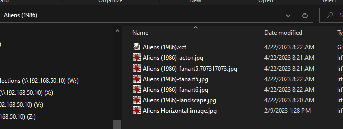

I just gave it a whirl....very nice...easy to use.
I made some changes to the array image types, see code below.
I also moved the location to the file menu as that is where I would put it (I understand current location makes access easy)
For the FanartSharp, the # sign is actually used for a place holder to support multiple fanart images as there can be more than one. There is always fanart.jpg.... always, media companion (which I use) offers up to 10 additional.... so there should/could be up to 10 more images in the folder. So it would look like fanart1.jpg, fanart2.jpg, fanart3.jpg, fanart4.jpg......and so on.
So I think it would need a modification so if in the pulldown you select fanart for the output of the image, then it enables a spinner. If 0, then fanart.jpg, 1 fanart1.jpg, 2 fanart2.jpg......and so on.
Not sure how easy that is implemented, but that is how the naming was established via kodi. The link is working now:
https://kodi.wiki/view/Artwork_types#fanart#
https://kodi.wiki/images/7/7c/LocalTVShowArtwork01.jpg
When export is complete, switching to the next movie, I found myself closing all the files and starting a manual selection of the next movie.
Most of this is done in a sandbox before moving to a storage NAS because trying to do it live could cause errors and that would be a bad thing.
So once save/export is done, that is where it should stop. I will think about the workflow a bit more and update if it makes sense to modify or leave as is.
The only other thought would be, the "bar" that shows status...is there a way to have a text label that says something like "Save Status:" above it?
I was thinking having a message prior to saving "Waiting for User Selection"... after options are selected... then it updates as it does now.
If not, no issue, just thinking out loud.
Let me think about the basic editing inquiry, that requires a bit of A > B > C > D thinking before I can make a suggestion there.
Marvelous work!! :jumpclap :jumpclap

kittmaster wrote:
SF-ADJUSTMENT  "FanArt only" '(0     0     30    1        10       0      0)
;SF-ADJUSTMENT  "slider name" '(value lower upper step_inc page_inc digits type)
By defaut the FanArt only numerical suffix is zero:
it is not added after "-fanart".
If the user clicks on the upper arrow of the spinner or moves the cursor, :idea:
FanArt only numerical suffix is added after "-fanart" and before the file extensionn ".jpg"
Finally, pay attention to the underscore :homer before the letter K of "KodiSave":
(script-fu-register "script-fu-kodi-save" "_KodiSave" "KodiSave V1.3" "AlSchemist"
It enables the shortcut Alt+File > KodiSave. :coolguy

The revision is exactly what I was looking for it to do... :jumpclap :coolthup
I gave it some exercise, it did generate one unexpected result and I can't replicate it, but figure I post it so you can see what I ran into and if you may have an idea what might have caused it.
I took an image from my NAS collection. It was the landscape image of Aliens (1986). I renamed it to "Aliens Horizontal image.jpg" for the sake testing.
I created a folder on my desktop: Aliens (1986) ----> Just as it would be as expected from intent of this script.
The order I tried before I noticed the issue:
--- I loaded the image in GIMP
--- Exported Landscape -> OK
--- Exported Actor -> OK
--- Exported Fanart - Spinner set to 6 -> Failed, added suffix unexpectedly as fanart5.XXXXXXX -> continue
--- Exported Fanart - Spinner set to 5 -> OK
--- Exported Fanart - Spinner set to 6 -> OK
Deleted all images except starting image "Aliens Horizontal image.jpg"
Replicated steps above, no issue all exported OK.
Not sure how to replicate this issue, only happened once thus far, so I'll try to track it, but figured I'd provide feedback incase you may have an idea what generated the issue.
It seems like an initialization variable may be needed set to 0?
I was going to take a look to see if I can manage that, but not sure as of this writing.
Other than that, this thing is excellent and amazed with the outcome, thank you again for the efforts, reading the code helps me a bit more to understand how scheme works. Never used this language before, so it is a good learning experience.
:paint :clap
Chris
File comment: Initial File for testing
File comment: Results from the explanation from above
 Post subject: Re: Shortening mouse/keystrokes save/export script or method to implem
PostPosted: Sat Apr 22, 2023 8:11 am  (#19)
Joined: Dec 27, 2022
Posts: 22
Also forgot to mention, it seems to be warning me every time it exports even though it works as expected. I did a normal export and it didn't flag any warnings.
Have no idea what would cause that, but noticed the behavior.
File comment: Warnings: Not sure why, but still works correctly...odd
This behavior is by design. Since, the KodiSave message in the status bar could disappear,
we use the Error window to persist the message as a warning even if it is not a warning or an error.
If you do not wish any message in the Error window, put in comment adding ";" in the beginning of the line 154:
(gimp-message (string-append "KodiSave: " fullSkin))
Do you remember if you moved the cursor or clicked to upper arrow of the spinner?
For unknown reason :crash , the FanArt only index was incremented from 5 to the float number 5.7073 :sword
To fix the issue:
  1. We removed the cursor keeping only the spinner: type = 1 instead of 0 in the last parameter.
    SF-ADJUSTMENT  "FanArt only" '(0     0     30    1        10       0      1)
  2. The procedure (define (KodiSkinPath path basename artTypeIdx fanArtNbr) has been improved to convert fanArtNbr from float to integer in case where the spinner would return a float number. Normally, the spinner should not return a float since the step is the integer 1 without any decimal dot.
How to convert a float to an integer in Script-Fu?
You can copy and paste the following code in the Script-Fu console.
(trunc (round 5.7073))
6
The boundary is at the half of the interval between 5.0 and 6.0: 5.5
(trunc (round 5.5))
6
(trunc (round 5.4))
5
Into the bargain, if there is a decimal dot in the conversion from number to string, we split the string with the known function strbreakup used to split a filename into a root and a file extension:
(car (strbreakup (number->string 5.7073 10) "."))
"5"
You can try without the function car to get the list of the numbers before and after the decimal dot:
("5" "7073")
Finally, if the issue occurs too often, put in comment adding ";" in the beginning of the line "SF-ADJUSTMENT".
Then remove ";" in the line below starting with "SF-VALUE". The spinner will be replaced with an input box initialized with "0".
