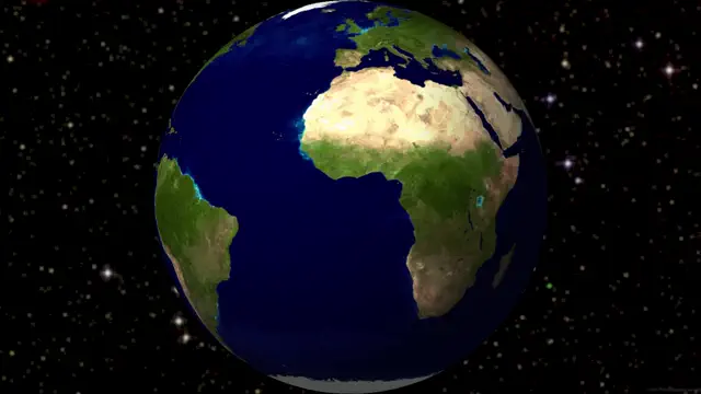

I did this one in Gimp using "spinning globe" plugin and composited it in a video editor because it's much easier that way. You can use it if you want...

Thank you very much. I didn't understand most of what you said but I greatly appreciate it. That is some of the problem I am having with gimp, I don't understand the language and I don't use gimp enough to remember what I did the last time. I will see if this animation you did will work. I will also check out the link you put in the post.

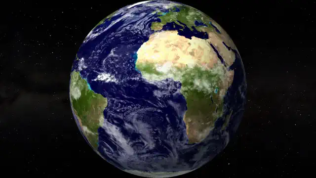

No problem, The only reason I posted is because I just recently upgraded my OS (Linux) and wanted to check that every program worked properly. Here is a version of Earth with clouds that make it look more realistic. Again use it if you want........

It looks a lot better with clouds and the Earth-Venus transition is very nice :bigthup

I can't agree more with Tas_mania :bigthup

Nice :) I like it with the clouds too
