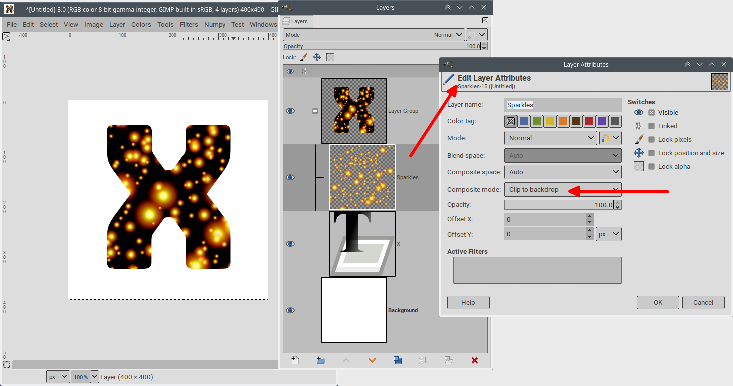

If you want a layer to be limited by the contents of another, the classic solution is to to "Alpha to selection" on the layer with the shape, and on the other layer, add a layer mask, and initialize to selection.
In Gimp 2.10, a better solution is to put the two layers in a group, and have the "Composite Mode" of the top layer set to "Clip to backdrop":
