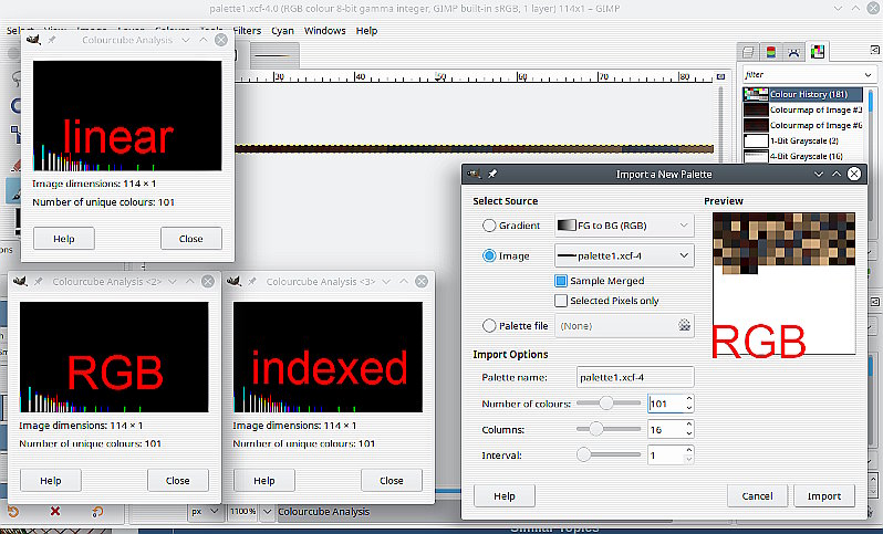

The image is in 'linear' mode. Change to RGB Image -> Precision -> Perceptual Gamma (sRGB) Then you can go Image -> Mode -> Indexed
As far as I can see no difference as reported by colorcube in the colours.

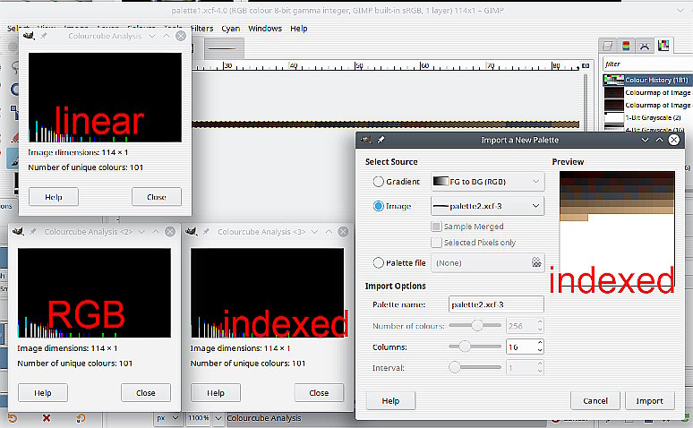

There is a difference in the distribution of the colours in a palette.
