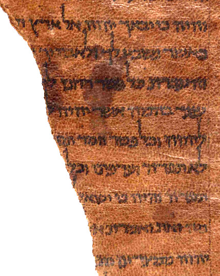

I've got a ~1000 year old manuscript I need to enhance so it reads as well as possible when printed in black and white.
I was hoping there was a good way to clean it up and make the ink cleanly pop on a white background. I've been struggling with it, though I've tried several different GMIC filters. If you can give it a try and post what steps you took, It would be appreciated.

It would be awesome if anything could be done to salvage any text on the first two lines which are pretty faded.

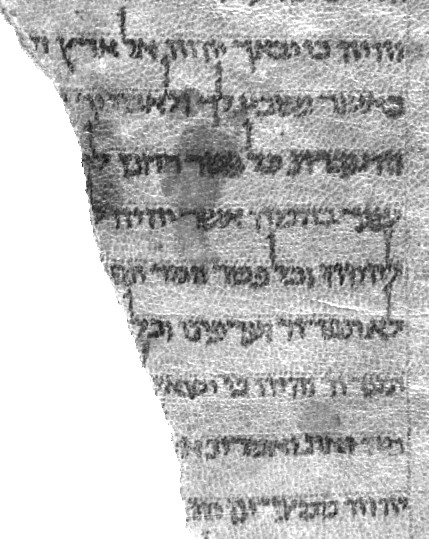

I would be hesitant to desaturate the image until you have something acceptable for printing. Treatment of separate areas and combining the results may be of benefit.
Here I have duplicated the original layer. Desaturated the copy using Colour to Grey (default values & Enhance Shadows selected) and changed it's mode to Soft Light. I then duplicated this layer. Overlay mode on these two layers gives a more contrasty result, but perhaps loses information in some areas.
I am sure others, more expert, will provide better solutions!

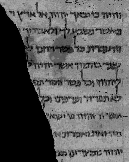

ok you could try this but it might not help at all
Here I tried Tone Enhance (move the sliders until you are satisfied)in GMIC then back in Gimp I did Desaturate in Multiply mode

Two more tries at this difficult problem!
The first of these I used my equal luminosity mask plug-in with the layer transition set to Hard.
The second one, equal saturation mask, again with Hard transition. I used brightness and contrast (curves) adjustments on each masked layer and set the saturation to zero.
Both of these plug-ins are dependent on Python 2.7 being installed.
As to whether the results are an improvement I cannot judge!
