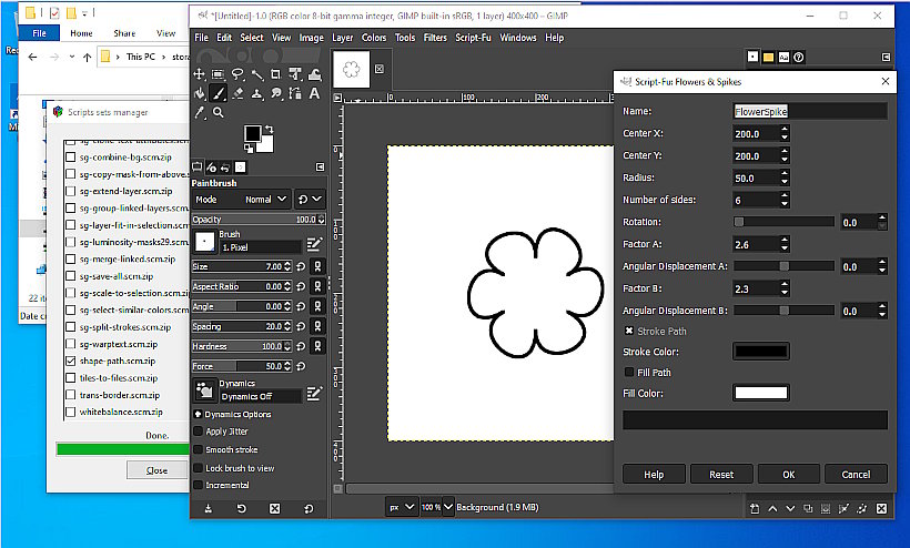

As you know I am a linux user and have used that plugin since it came out. I have plenty scripts only used occasionally, not worth cluttering up the menus permanently. I normally use an .ini file but without one.
I was looking at the samj Gimp 2.10.36 for someone else so I still have it in a Win 10 (VirtualBox)
I am sure you know all this, in the Preferences folder: There is the plugin, (1) With a scripts_storage folder (2) containing zipped scripts (3)
..and does it work - this the shape paths script
Definitely not a given that it works first time, but it does work. I needed a couple of re-starts.
First thing to try is delete the Preferences -> pluginrc file to force a re-scan of the plugins. It should not be necessary but you never know.
Another one. If there is an existing .active file in the scripts_storage folder delete it.
