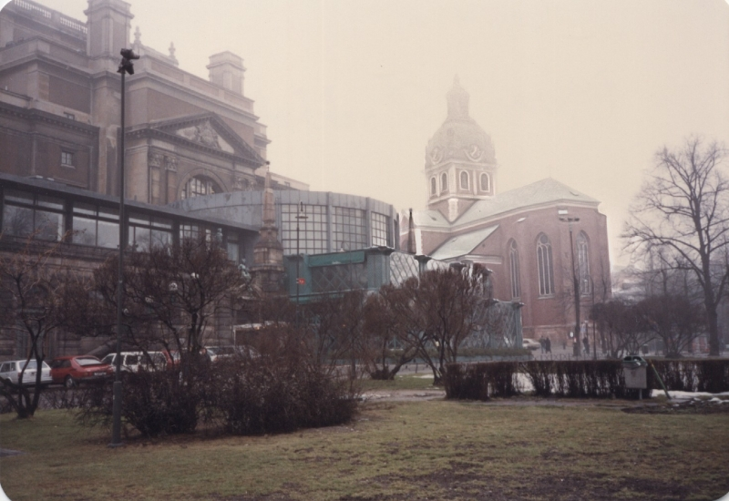

Hi all,
Please advise how to make the church tower clearer ?
Thanks
Regards

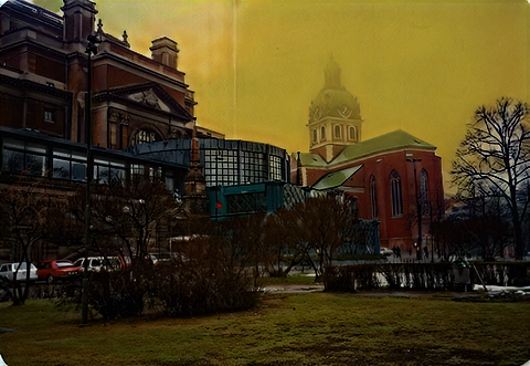

Posts: 12855
Luma invert overlay to enhance the colors, healed the corners, and then Upscayled the image (AI). :)
