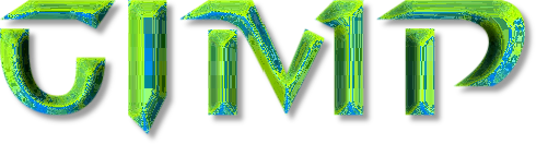

I'm going to post that tutorial over here so others can give it a try. I do know that the slider on the first tab can brighten the text ... try sliding it back and forth. I'd really love for that preview window to be bigger because it's very difficult to see the results.
LATER EDIT: The tutorial is in Gimp Chat now.
http://gimpchat.com/viewtopic.php?f=10&t=230
Also, Jolie has done a video tutorial about it.
http://gimpchat.com/viewtopic.php?f=10&t=142
This is the slider I mentioned in the first tab.
This is the text I made while getting to that screen shot. After I was finished, I went to Colors > Curves and moved both buttons inward about one rectangle apiece. It brightened the text a little.
