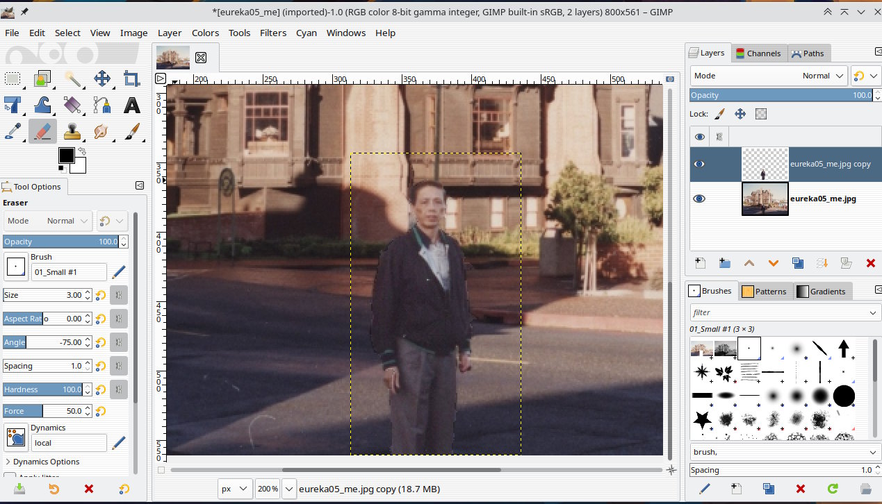

This I duplicated the layer and a small adjustment with the curves tool to lighten the whole layer.
Crop the subject out (you can see the layer boundary) and remove any remaining background. Since you have gimp_gmic_qt plugin , the interactive foreground removal filter works really well.
Then you can sharpen up the bottom layer any way you want. Lots of sharpen filters in gmic.
