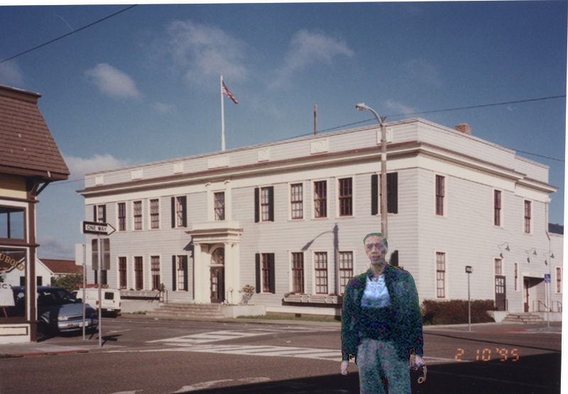

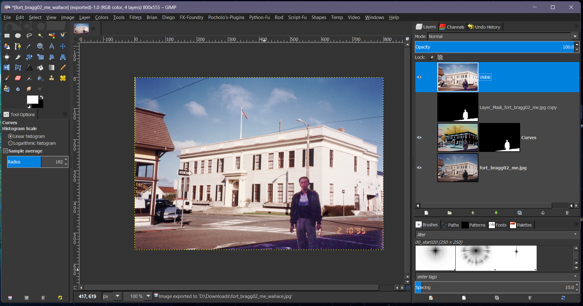

This is the best result that I could do using a layer mask on the shadow.
Also playing with curves and finally trying color auto-normalize.
My final results.

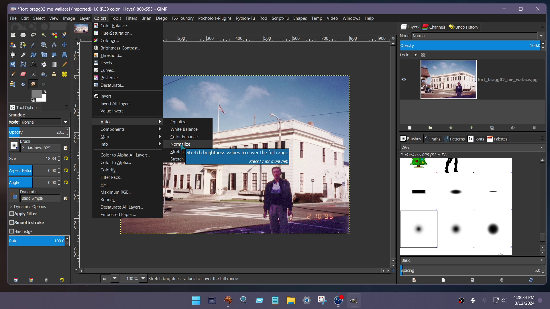

I used 2.8 and this falls under Color > Auto > Normalize.
Unfortunately Normalize is on longer available in 2.10.
This auto color filter is suppose to stretch the brightness values to cover the full range.
I believe the filter was use as the last step.
I'm also not sure if there is an equivalent in 2.10.
Here is a screenshot of 2.8. showing the filter.
File comment: Preview of Color > Auto > Normalize

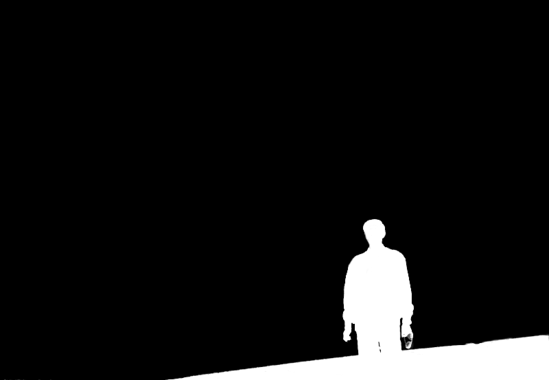

Here is a layer mask I made that can be used with this image.
Not a single selection was use to create this layer mask image.
File comment: Layer Mask
Paint out the surrounding bits of dark and paint in the few light areas to create the mask.
White is full opacity,
so the layer mask color should be inverted as a final step.
File comment: Color Curves applied to desaturated copy.
