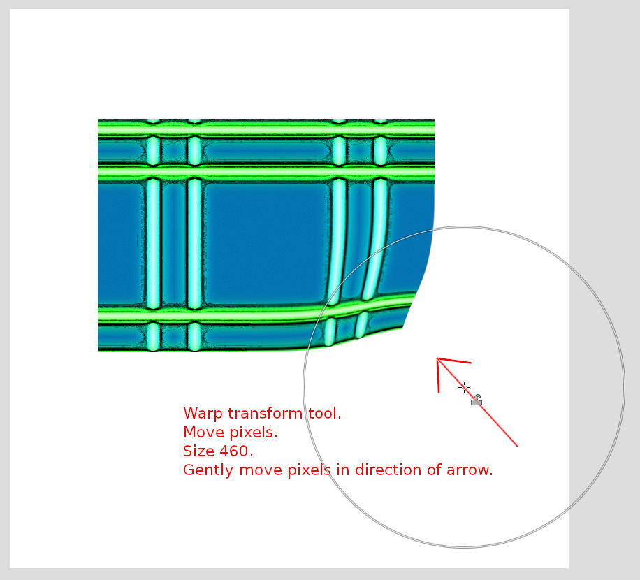

Hi Ella and OMG,
Nice result OMG. Using your tip, here's my try and how I did it.

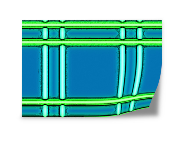

Gave the corner lift another try with a different method:

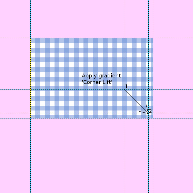

Part 1 of 2 displace the corner.
Download and install the gradient attached to the next post that I've called 'Corner Lift'.
Start with your original picture layer cropped to content and smaller than the image canvas. I've used a layer filled with a gingham pattern as a test case.
Duplicate the original picture layer and set the layer name to displace map.
With the gradient tool with all default settings, apply the 'Corner Lift' gradient starting at approximately point 1 as shown below and ending at approximately point 2.
The result should look like this:
