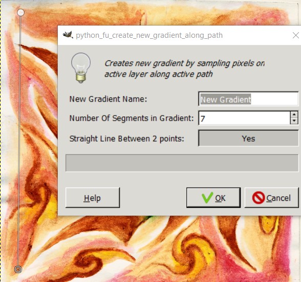

Hi meetdilip
Open an image and make a path
Tools - create a new gradient along the path
write a name for it
you will get your new gradient on your list.
I hope it helps
Here my plug-in

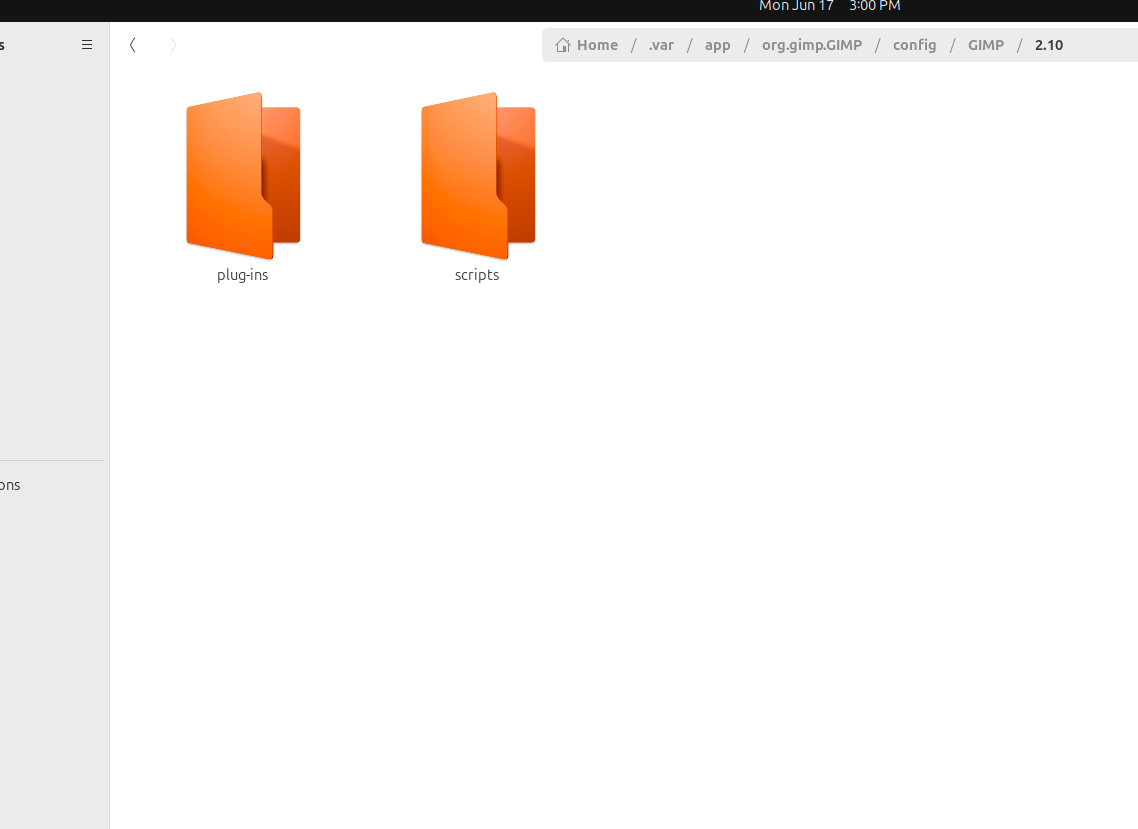

Hi, thanks.I add it to Home > .config > GIMP > 2.10 > plugins
But I do not see any options under Image or tools. Thanks.
Screencast - https://imgur.com/8nIkbGQ

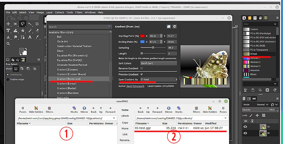

It probably depends on if you already have a regular existing Gimp 2.10 installation. This in a Mint 20 VM and a Gimp 2.10.36 flatpak. (A bit old but I can not be bothered to update, just useful for demos)
Two possibilities.
(1) The flatpak gimp_gmic_qt plugin.
A bit strange, the new gradient appears in the old Gimp 2.10 gradients folder (2) not the .var (1) one which you might expect.

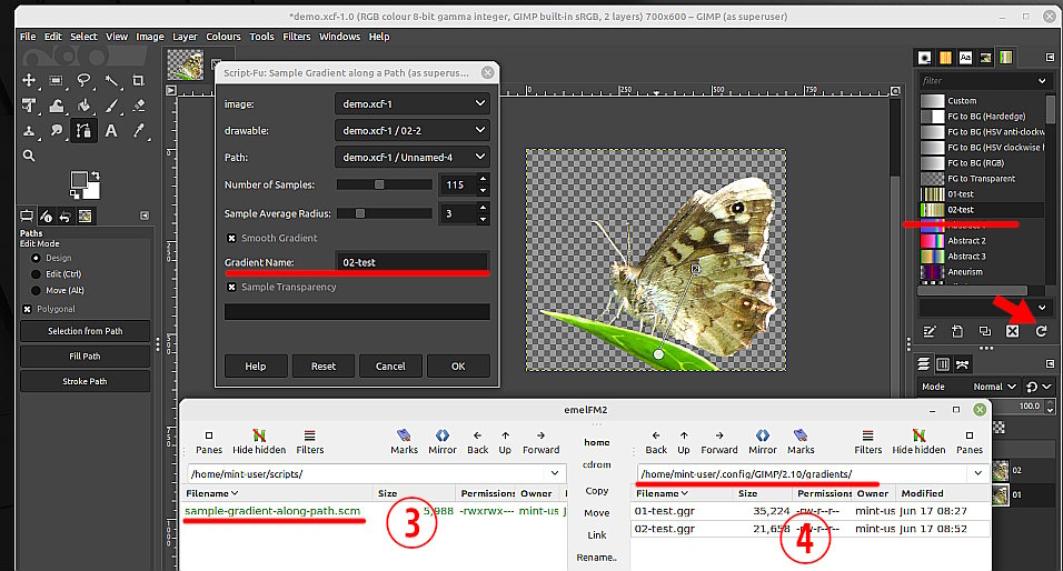

(2) RobA's script. This did not show when in either of the regular script folders .config... or .var.... I had to make a scripts folder in home (3) and add the location to the Preferences -> Folders -> Gradients scripts paths.
It does work, beware of the dialog "popping under" the Gimp window. Refresh the gradients for a write to... the old Gimp 2.10 gradients folder again. (4)

Just used the gimp_gmic_qt plugin again, this time my regular Gimp 2.10.38 and gmic 3.4 - works as expected - puts the gradient file in .config....etc Maybe try updating the gmic filters in the flatpak Gimp. Edit: or it might be the name you have given. Try something simpler, without the path.
RobA's script is registered as context. -> Right Click in the Gradients Dock, it is down at the bottom of the menu.
Obviously works for me, all depends on your setup.
FWIW a couple of videos
https://i.imgur.com/RFYUdrz.mp4 This one using gmic. I have a file manager open in both .var and .config gradient folders. Refresh the gradients to write. The file goes in .config. ...gradients here.
https://i.imgur.com/FKNYxLN.mp4 This using RobA's script. File manager shows it is my Home partition. Note that when starting the script it pops under and you need to bring it to bring it up. Same as before, refresh the gradients (or close Gimp) to write the file.

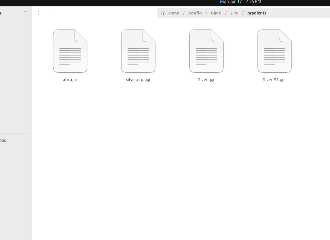

Finally ! I don't know what was wrong or how it got fixed. The .config > Gradients folder is full of .ggr now :)
